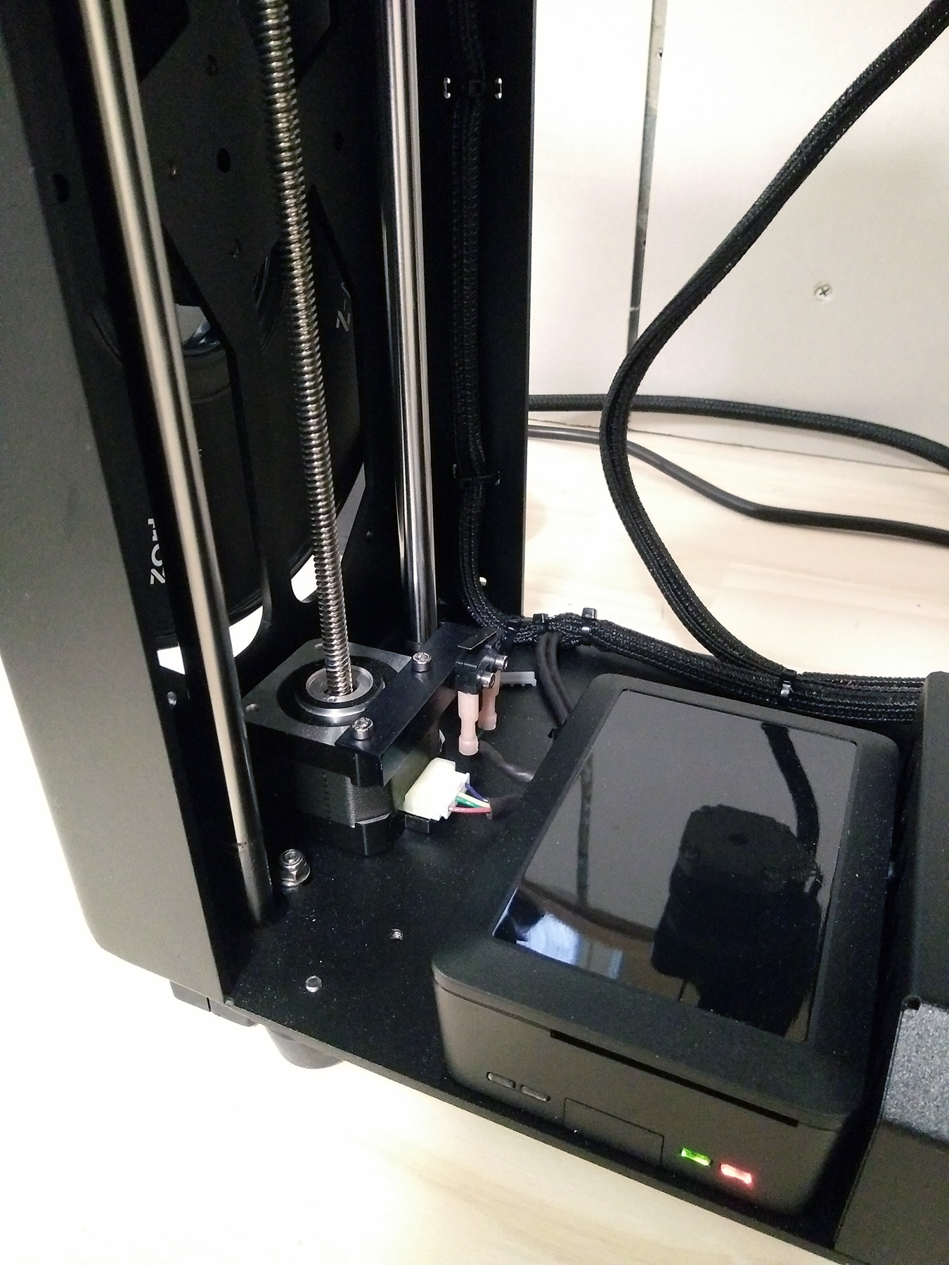

I'm not sure about the endstop switch holder. I can't see how mine could slide down? (image attached)

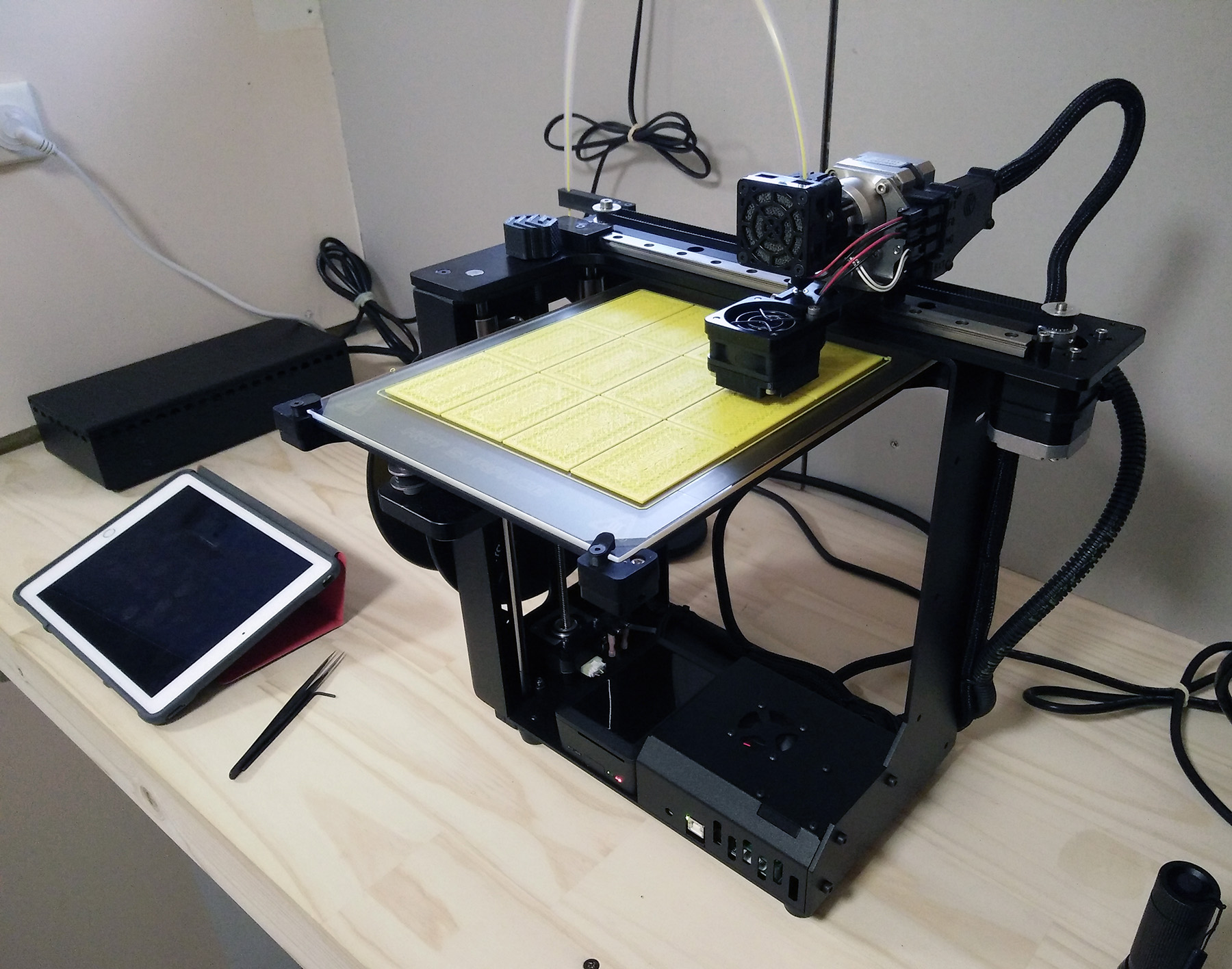

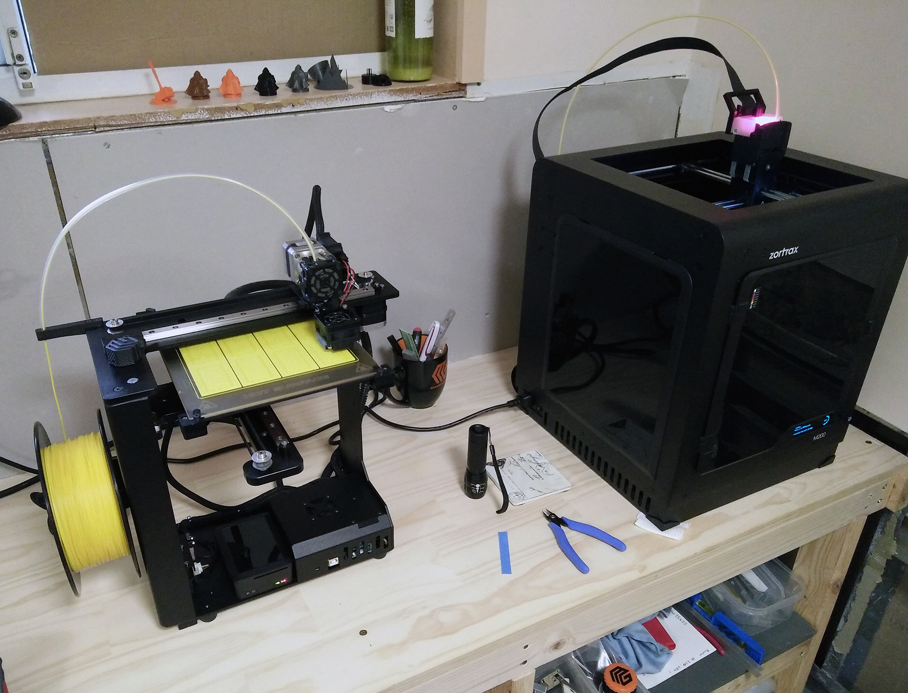

I have also uploaded a few pics of my M3 in operation. I am certainly very happy with the M3. I am still amazed I can print ABS without an enclosure. my Zortrax sitting next to it still has issues with ABS, with ABS juice on a perforated heated plate.

Yeah looking at that new bracket there's no way that thing is moving... (that's a nice upgrade they did there) and come to think of it when the bracket slides down on mine it makes the nozzle farther away from the bed not closer.Evan wrote: I'm not sure about the endstop switch holder. I can't see how mine could slide down? (image attached)
