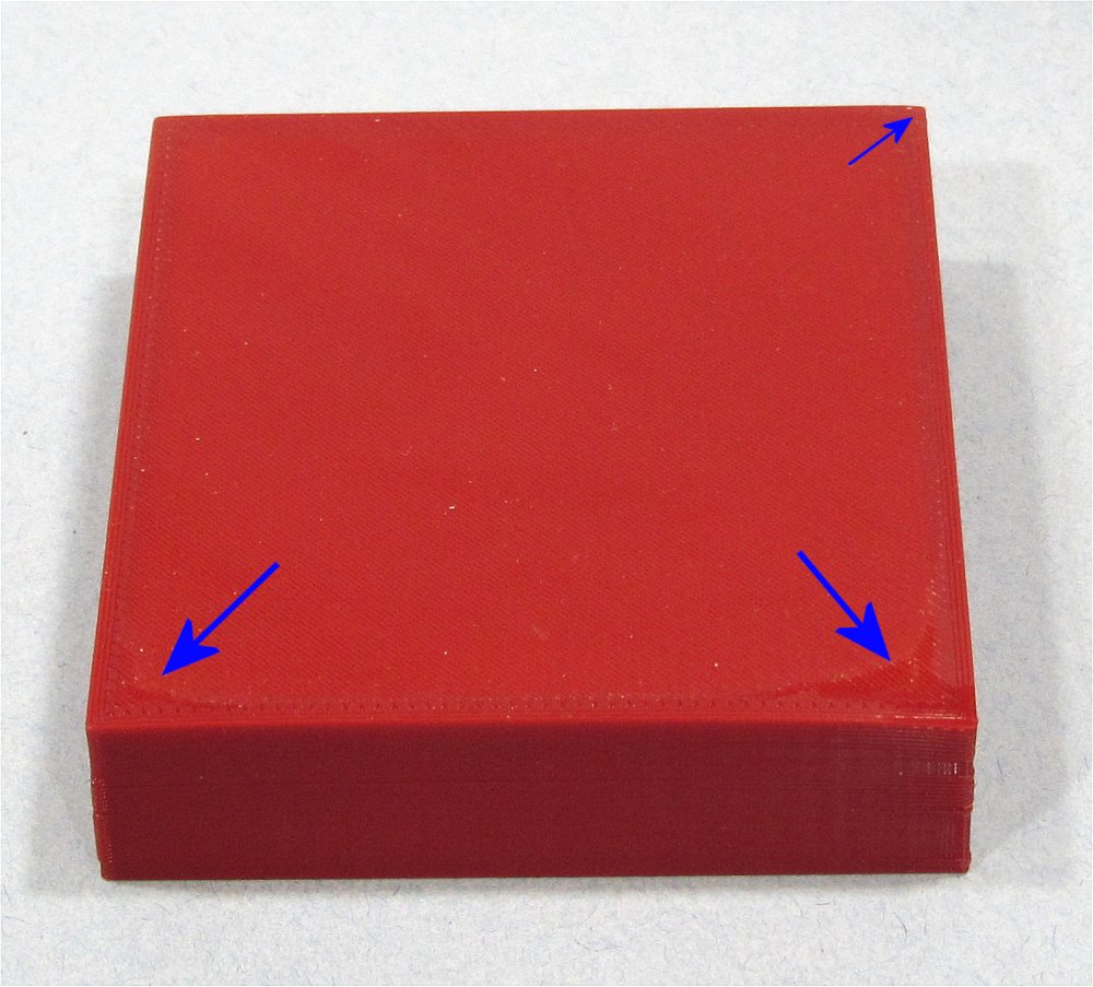

I've found that the stock bed fan geometry is part of the problem. I'm printing rectangular parts roughly 3" square. At least with some really warpy PLA, reducing the cooling helps a lot, but I get to a point where the back sticks down just fine where it is shielded from the fan by the rest of the print. The front is constantly getting cooling, and still warps a bit.
I'm investigating fan shroud designs as a result...
