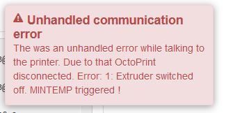

Been getting these. Googling turns up two schools of thought.

MINTEMP comes from RAMBo, full stop. There's nothing to do with a Pi in that error.

Starting with the first "Error:1" line, everything stems from the MINTEMP failure.zemlin wrote: I don't see any temperature issue on that last report
Improving the power supply eliminated the spurious checksum error, which is definitely progress.
Because Marlin doesn't know which extruders you'll use during the print, I'd be unsurprised to discover a thermistor failure on the "inactive" extruder will also trigger a shutdown. Alas, the error message doesn't identify which thermistor produced the spurious reading.replace the thermistor on the left extruder (the one I'm running)
I'd replace the thermistor on the right extruder with a known-good one, as it's the most likely remaining zebra.
