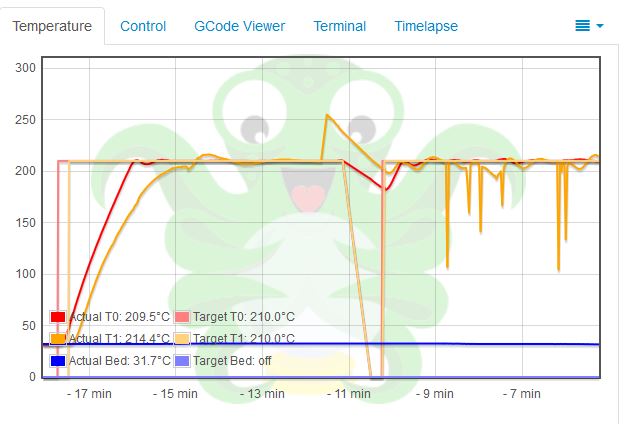

Already replaced the other thermistor.
Re: Octoprint Unhandled Communication Error
Jason at Makergear asked me to heat up the extruders and move the carriage left to right manually.
Looks like I have another broken wire.

The final zebra!zemlin wrote:another broken wire
Look on the bright side: you didn't buy a spare RAMBo ...

Called it!
