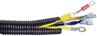

Has anyone tried this stuff to temper the bending of the wire harness?
Does it hold up to the constant flexing?
Also considering some thin fiberglass or music wire strands in with the wires. I tried PETG filaments, but they did not last.

zemlin wrote:Does it hold up to the constant flexing?
Nope, those corrugated tubes are intended to tidy up the wires in a fixed installation.
The braided loom around the wires from the extruder to the RAMBo (on my old M2, anyway) works better:
https://www.amazon.com/s/ref=nb_sb_noss ... ble+sleeve
Adding a clamp with a flared entry to guide the flex over a few inches on each end would be just about ideal.

zemlin wrote:Has anyone tried this stuff to temper the bending of the wire harness?
Actually, the corrugated sleeve is what my relatively new M2E came with on the harness that goes from the electronics box to the bed/Y-axis assembly. All the other cables are in the braided wrap with zip ties in strategic locations.
