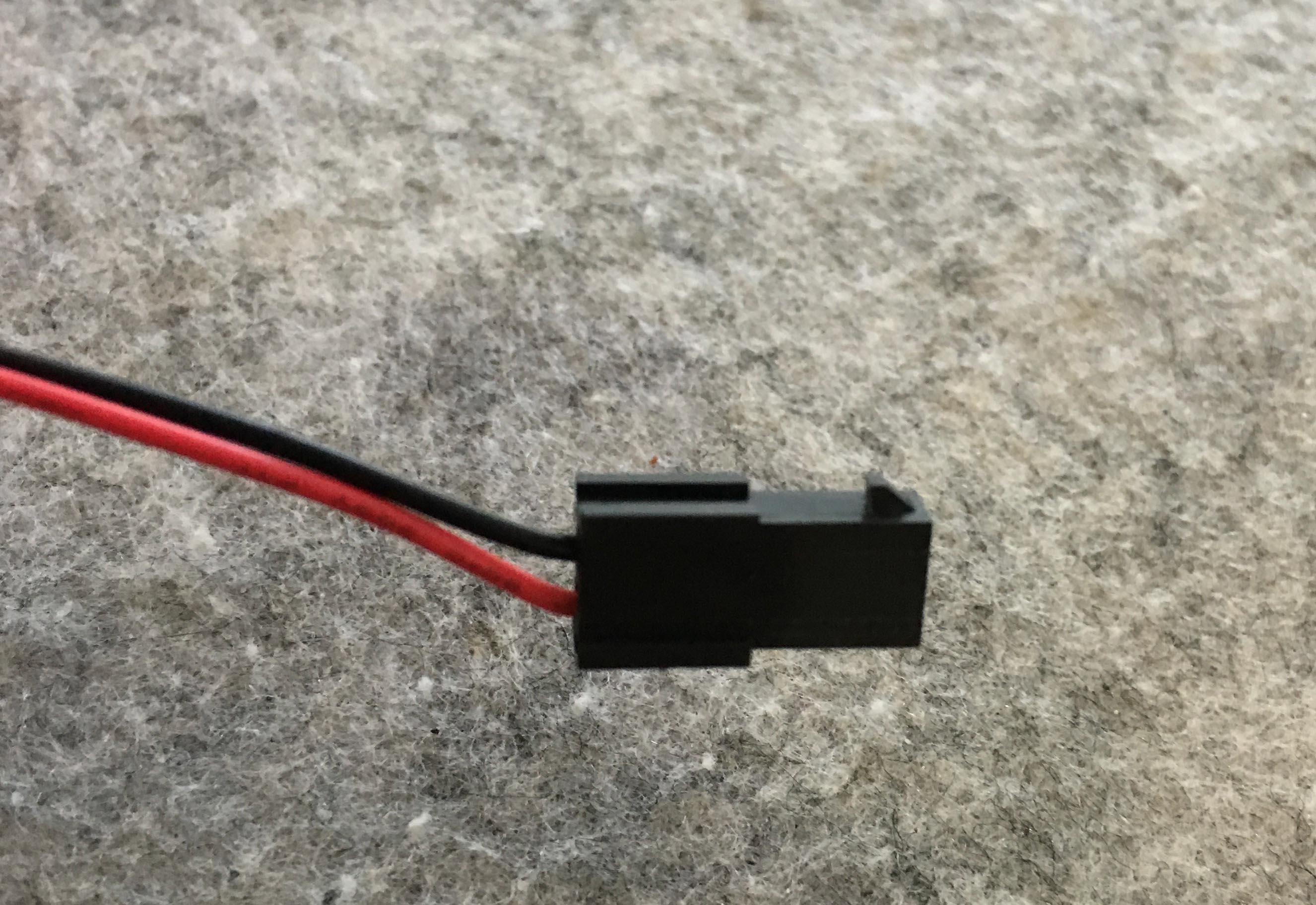

Hello, where can I find another connector for the hot end fan?
I want to experiment with a blower and I do not want to ruin the original fan and connector.
thanks!

Post by jimc » Fri Oct 20, 2017 3:39 am
newark.com
pt# 43020-0201
pins: 43031-0008
sockets: 43030-0008
here are the #'s for the other connectors on the m2
43645-0200
43025-0200
43640-0201
pin extractor tool: 11-03-0043

Thank you, I just ordered a pair, and how do you affix the wire into the othe end?

Post by jimc » Fri Oct 20, 2017 10:01 am
Crimp on a pin or socket and just insert it into the connector. A small pair of needle nose pliers will work to crimp it. Its a one shot deal. Once its inserted you need the tool to remove it

Thank you what are the specs of the pin? And where do I find them? I don’t have them in my own lab so I probably will have to buy some.

Post by jimc » Fri Oct 20, 2017 1:01 pm
Right in my post

Thanks i’ve already ordered from the other company and shipping is 20 times more than the part they’ve already processed the order, is there anywhere else to buy the Pins such as RadioShack or another electronic store?

Post by jimc » Fri Oct 20, 2017 2:13 pm
Just other places like newark. Mouser or digikey etc. try typing the part # in on ebay. There are probably sellers there

Post by Gwhite » Fri Oct 20, 2017 2:32 pm
You can buy all the pieces from Digikey, and their shipping charges are generally lower than Newark:
Connector Body: https://www.digikey.com/products/en?keywords=43020-0201 (32 cents each)
(Two position plug, top latch)
Pin Contacts: https://www.digikey.com/products/en?key ... 43031-0008 (24 cents each)
Socket Contacts: https://www.digikey.com/products/en?keywords=43030-0008 (24 cents each)
Other Connectors:
https://www.digikey.com/products/en?keywords=43645-0200 (2 pin horizontal receptical, side latch)
https://www.digikey.com/products/en?keywords=43025-0200 (2 pin vertical receptical)
https://www.digikey.com/products/en?keywords=43640-0201 (2 position plug, side latch)
The contacts are supposed to be installed with a fancy crimper, but the official Molex crimpers can cost more than $300, and you need one for each sex of contact. You can do an OK job with a pair of pliers, but if you think you may do a lot of mods or repairs, a proper crimp tool is really useful and cheap general purpose hand ones are available. I've used one of these on similar connectors, and I'm sure they will work much better than pliers for the Molex pins as well:
https://www.digikey.com/products/en/too ... 28?k=pa-09
