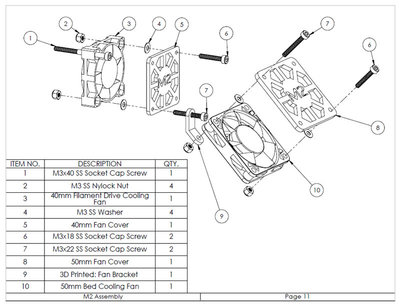

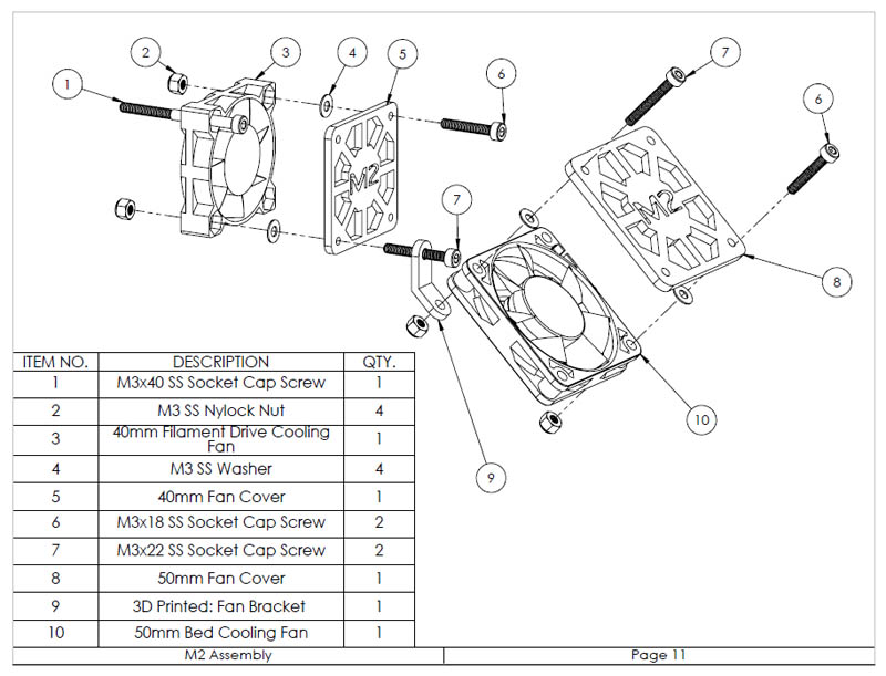

I've had similar noises on my printers it was always from vibrating washers...
Check the ones (#4's in picture) in between the fan and the fan guards and see if that is where your noise is coming from.
