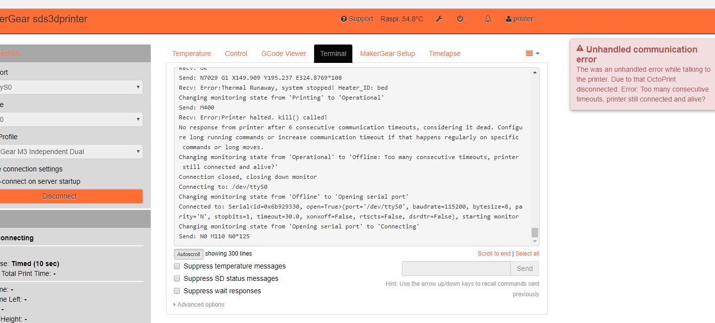

I'm getting a Thermal Runaway on the Heated Bed when I try printing at 110C on the heatbed. It'll go up to 97C without issue, but after about an hour of printing at 110C, the whole thing shuts down. The OctoPrint interface shows disconnected, but pulling up the terminal, I get "Error: Thermal Runaway, system stopped! Heater_ID: bed". Is there something I can check before sending the unit back to MakerGear? In the middle of a major customer print, so really trying to avoid having to send back if possible.
