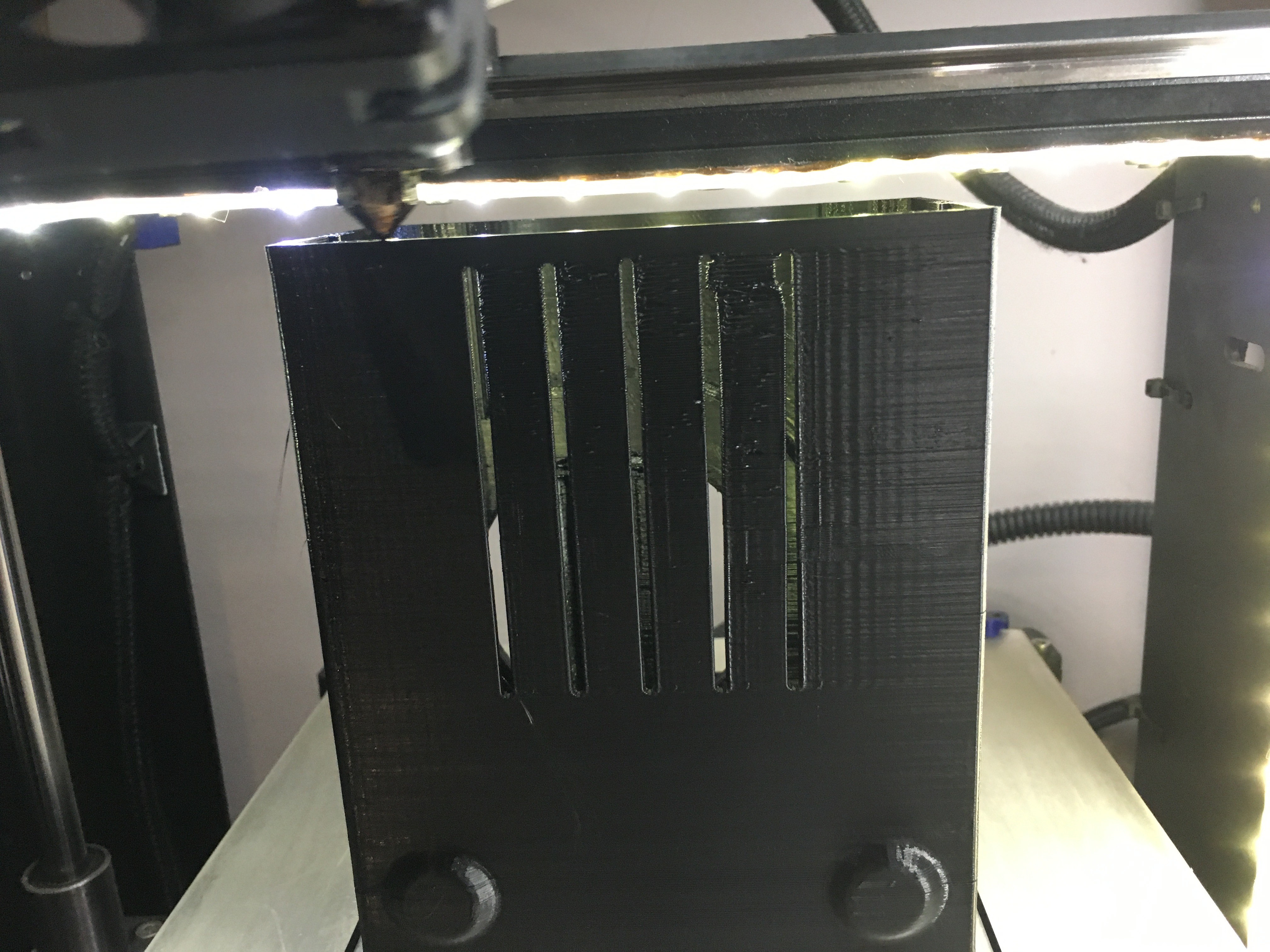

what could have caused this shift during a very long print?

what could have caused this shift?

Re: what could have caused this shift?
Easy.
Your design has very long slat pieces. This is not an issue unless you print them upright like yours are oriented. Those long parts are just shaking all over while printing.
You can notice how the print quality on slats gets worse the taller they got. I think you are lucky that it was only off a bit and did not cause a major failure from bumping the printhead.
The fix would be to add some small tabs between the slats so they are supporting each other at a couple of spots.
Also, no fan for PETG. High bed temp. No air fan/vent blowing directly on the print bed.
Thanks, I agree with you but the damage was only in one very specific area, maybe the print caught on the nozzle.
No fan at all? Don’t you need it for bridging?
