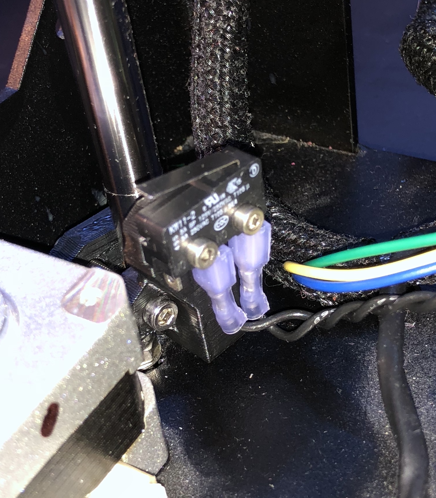

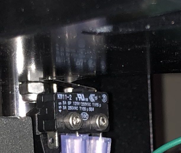

Here are my photos...
You can see that with the Z switch pushed all the way down the platform barely engages it when it is lowered.
I'm not sure how much you expect the switch to be triggered or how much to raise it. I don't want to put undue stress on it, but also want it to trigger correctly. Then do I need to put something under it or simply tighten the bolt....

Post by insta » Thu Feb 08, 2018 4:56 pm
I just bent the lever slightly
