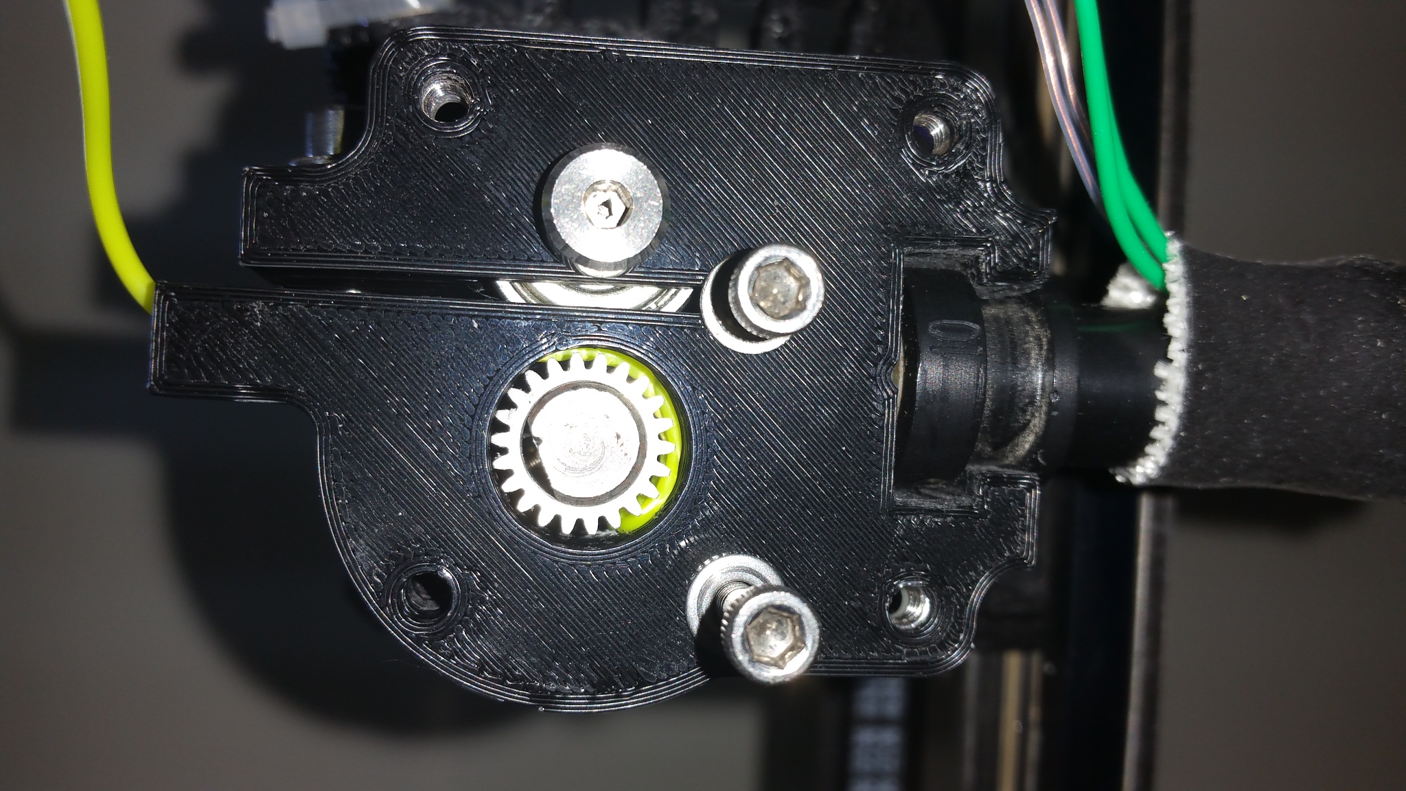

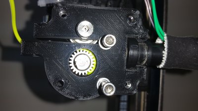

I'm experimenting with this TPU filament https://goo.gl/iDUQVi, it's more like flexible PLA than true TPU. It prints very nicely, however filament drive would jammed randomly out of nowhere, see photo. Any idea how it would jammed like this?

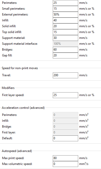

Here is my Slicer settings. Thanks

I don't think you'll get TPU out of a V3a. The melt zone is too long.

insta wrote:I don't think you'll get TPU out of a V3a. The melt zone is too long.
The filament is sort of a hybrid between PLA and TPU, it's stiff and yet flexible. It printed nicely without problem after up the temperature from 185C to 210C.
