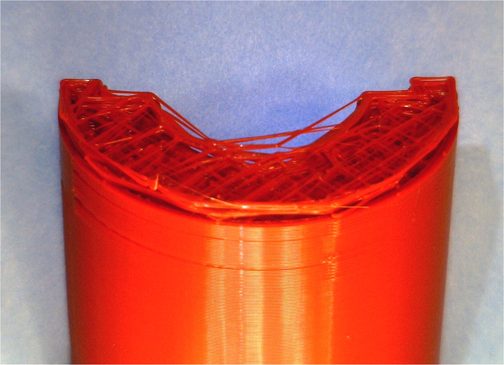

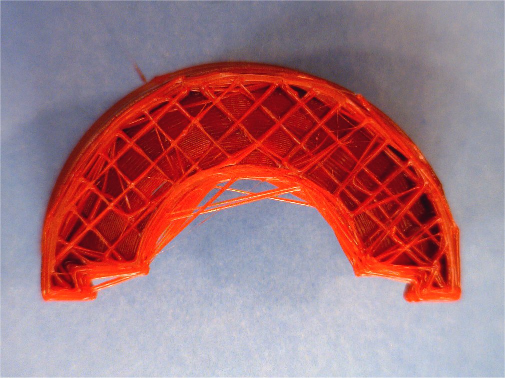

Well, that time it only went about a half an hour before it messed up big-time:
I restarted the job (again...) after tightening up the tension another 1/8th turn. It's doing just fine again, but I view the odds of getting a successful print as pretty low.

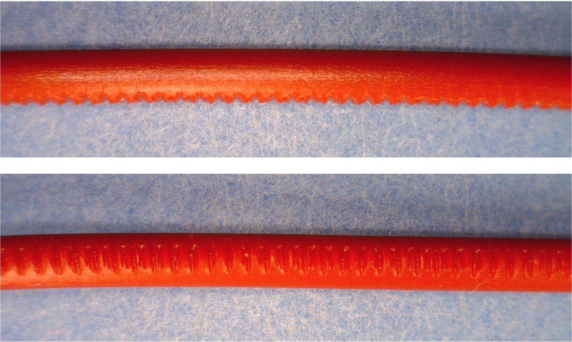

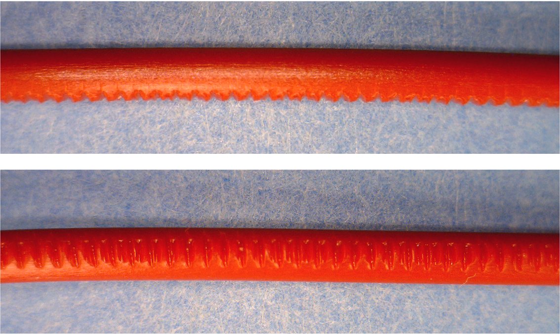

Here's a couple photos of the teeth marks in the red Paramount filament after I increased the tension this morning. It certainly looks like it's got a good grip. Either the filament diameter is varying a lot, the spool is jamming up occasionally, or something weird is going on...

Your tension looks fine, but Ed’s sprung screw looks like a great trick. I would probably look elsewhere for the cause.
