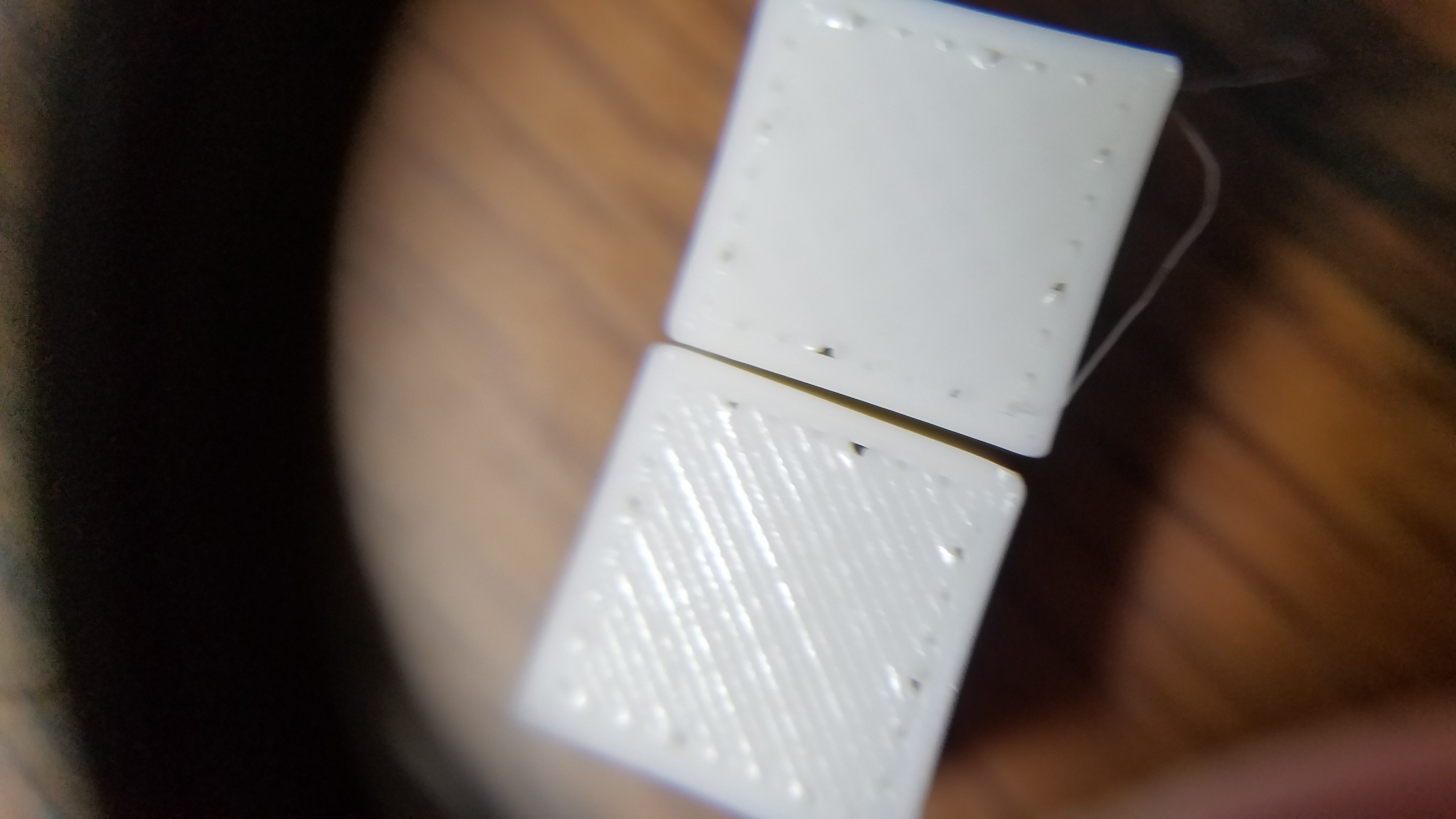

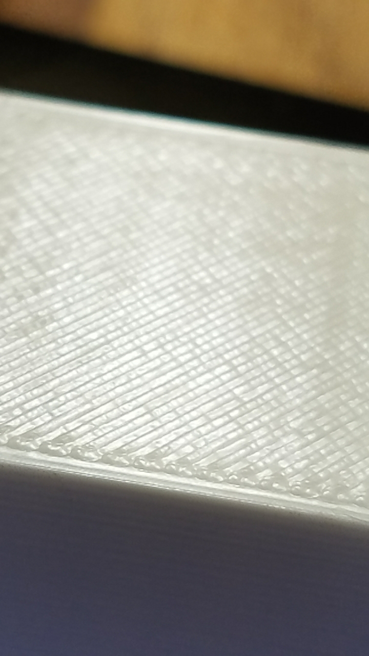

New guy here, not sure what I can expect to achieve with the M2 and PLA, boat loads of stuff to learn..
Printed 20x20x20mm cube using PLA high quality setting of S3d standard M2 profile.
Did some temperature tuning to get the least amount of distortion
Z 20.01+- .02
Y 19.84 +.02-.03
X 19.89 +.02-.03
Then printed a 10mm cube
Z 10.01 +-
Y 9.81
X 9.89
Is this within normal expected tolerances?
Can this be corrected at the machine level, mechanicaly (would think not) or is there a way to compensate within S3D?
I am using the stock 3.5mm, are these gaps at edges normal when printing small items like a 10mm cube? I did not get these when printing the 20mm.
See below
10mm
20mm
Thanks in advance

airscapes wrote:not sure what I can expect to achieve with the M2 and PLA
Always remember: a 3D printer produces an object by squeezing molten plastic through a nozzle slightly smaller than a grain of salt and mashing each layer atop a gummy tower of cooling plastic. These pictures may help you see what's going on:
https://softsolder.com/2015/11/12/3d-pr ... alization/
With that in mind, you can expect XY dimensions within 0.2 mm and Z dimensions within 0.1 mm, pretty much day in and day out. Although you can tune any particular model better than that, those settings won't optimize a dissimilar model.
Your results will improve with increasing attention to detail:
  • Measure the actual filament diameter and set it in the slicer
  • Calibrate the Extrusion Multiplier after changing filaments / temperatures / whatever
  • Verify the platform alignment
  • Plastic shrinks as it cools. If that matters, calibrate appropriately.
Treat your M2 with reasonable care, don't beat on it to knock objects off the platform, and it'll crank out surprisingly precise objects like clockwork.

airscapes wrote:work well as it but have room for improvement
Absolutely! Kinda-sorta by definition, you can tweak the process to optimize any feature you want: speed, surface finish, strength, repeatability, whatever. However, you can't optimize everything at once, so there's no "best" collection of printing parameters for everybody. You get to decide what's important, then adjust the settings to make it happen.
gaps in my top layer
Have you measured and set the actual filament diameter, then calibrated the Extrusion Multiplier?
Until you get those adjusted properly, you're wasting your time doing anything else.
