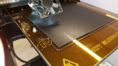

Hey what would cause this under extruded condition on the closest corner in the image, you can see the reflection between each thread.. just did a bed level and set up this nozzle for extrude width and start height using a single wall square and caliper. This is the second time I have run this single .2 layer and it has gotten thin at the same place each time.. Does this indicate a low corner.. or is it high? When leveling using the quick start app the corner where it is thin on extrude was claimed to be the highest corner..
Or is this just having the extrude multiplier dialed in and the filament changing?
