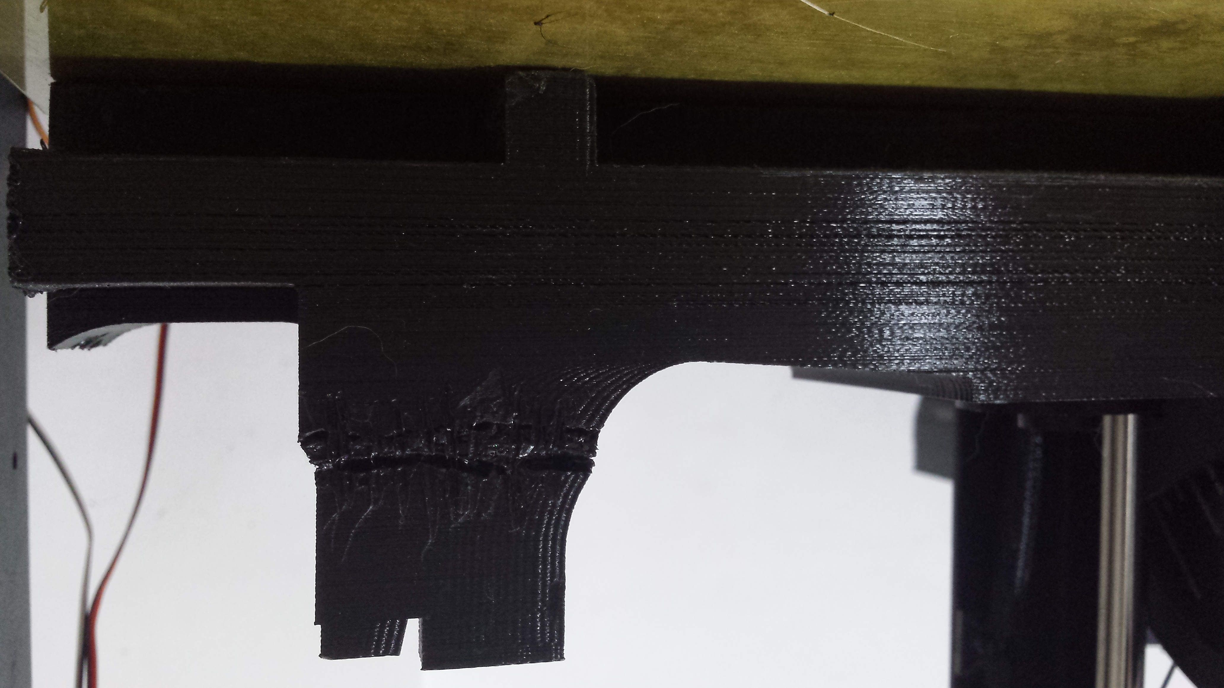

Hi guys,
I use M2 v4 printer and HatchBox PLA only
I have a problem in printing mostly seen in middle and big prints that has cracks so the item easily can be broken
My extruder temp is 210 cel. degrees and the heated bed is 6o degrees . I use MIC6 aluminum plate and PEI over it as bed surface Primary Layer Height 0.15 mm .
Any advice ??
should I try to raise temp to 220?
Regards Doron
Any advice ??
Regards Doron

You might want to put up a picture. That would help.
Slow down your speed and give the nozzle temp. a bump up.
If the item is large then you may want to try thicker layers and more perimeters.
Hard to know without seeing it.

It looks like you are having a problem jumping over a space in the printed item.
It is possible that an area of your print has a corner that is lifting up and it is bumping your print head.
Is the trouble spot a thin wall or have sharp edges? This can cause bumping.
If you are using Simplify3D, then you may want to enable a small amount of Z-lift to prevent the head from bumping the print.
You may need to modify the CAD model to have a thicker area or round over the sharp edges with fillets.
If it is happening in the same area over and over, you may want to use the print preview to check and make sure the g-code is not doing something unusual and causing printing trouble.
If there is an error in the model, such as not being manifold or watertight, this can also cause print errors.

If you are using S3D please post the factory file so we can take a look at everything.
Do other items print nicely? with smooth walls or do all of your prints have crack between the layers?

Hi guys
the print that i sent the pic is a straight surface
I tried to raising the extruder to 220 degrees cel. and use a 0.1 Primary Layer Height ( it was 0.15) . the prints look now much better
Yes I use S3d ver 4
I attach the FFF file may be you can see some thing more i can change to make prints be nicer
Regards ahead Doron
Yes I use S3d ver 4

Does the rail bed have issues when it is printed?
It would have been better to get a factory file of the part you posted the image of.
Since you posted the rail bed I will comment on what I see but I have only been at this game for a few months so not an expert yet.
One thing I do know nothing is plug and play and there is much test and adjust for every model and every roll of plastic.
If you have not gone through the process of setting your extrusion multiplier with a single walled square and a digital caliper for an extrusion width of .42, then I would suggest you change the extrusion width to manual and set it to .4 which is the default for the M2 profile if I recall correctly
For something this large and void of detail I would set the layer height to .2
Your first layer is set at 50% of height.. now sure why you would need to alter the defaults, so if you are not sure why you did, maybe set them back to default of 90% 100% and 50% Not going to change much on the rest of the print.. but seems
I would also have the fan start with layer 2 not 5
Speed for something this size should be able to go faster the 30mms I would probably try 55 or 60
If the areas where the supports are is not looking too good, reduce your horizontal offset. I use .1 for miniatures and 0 for curved as it will be too far away on the curves
Other thing that I assume are correct are the starting height and bed level.
