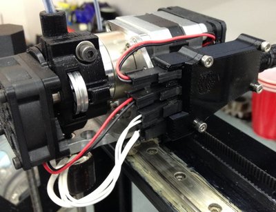

My issue is the extruder drive design not the settings. I was running cleaning filament and following the manufactures instructions. This issue is the filament jams up in the drive. To much or too little tension and nothing to hold the filament in line if it starts to push out to the side. Then there is the issues of NO good way to know how tight you are other then measure the gap in the clamp or extract and look at the marks I will not even attempt to print EPA until I design a modified drive housing or get the guy who has done so already to share or sell the SLT (Dave where are you?).

Would be nice to be able to remove the pla, run a few inches of cleaner and go back to printing without changing the drive tension.. or at least having a way to get back to the proper tension quickly without extracting to look at the gear mark depth. I think with the proper u or v bearing and some adjustments to the drive housing this could work really well.. this is what I am talking about...
viewtopic.php?f=10&t=3210&p=23538&hilit=Drive#p23535

I just measured it a little while ago and yes, I see that it is all over the place and I did see your mod last night and was planning on checking my little box of springs. That is something can do with out much effort and it makes a lot of sense! I would love to try and mimic Dave design in the image above but have a lot of models to print and don't want to take the printer apart to measure and model. I did find a mode of the Rev E drive housing designed to add a touch sensor so maybe I should just print that and use that to do my one model.. still need to know the bearing ID and OD to try and make a sleeve or fine a U bearing that has a very shallow U to support 1.75mm filament.
Check out viewtopic.php?f=7&t=6565&start=20#p36314
The stock bearing is 5mm bore, 5mm thick, and 16mm OD. McMaster Carr has a 14mm OD bearing (#7804K109). It should be possible to make a press on sleeve with a small groove to keep the filament from wandering sideways. That would allow using the stock extruder housing.
Do you think a 1mm thick printed sleeve would be thick enough? seems too thin to press fit tight enough.

It doesn't have to be a super tight fit, and you could even use bearing retainer adhesive on it. Also, it's only going to be ~ 1 mm thick at the bottom of the groove. The rest of it will be at least a half a mm thicker.
I've got one of the bearings, I just haven't had time to make the grooved sleeve. I''ll need to grind a small form tool to cut the groove. I think I will use aluminum so that if it ever get cranked into the drive gear, it won't dull the gear too badly.
