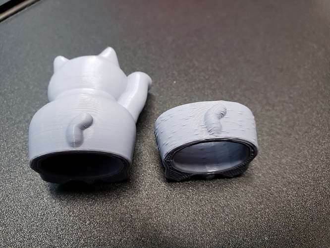

There are a few threads regarding lower print quality using Octoprint VS printing from an SD card using the same gcode file. Here is one:
https://discourse.octoprint.org/t/poor- ... rd/3743/40
I am experiencing the same types of artifacts on roundish, organic models as discussed in the thread above.
There is some thought that on some types of models, the Pi’s used in Octoprint setups can't feed the gcode to the printers fast enough causing micro delays that result in lower quality. As a troubleshooting step, I was hoping to eliminate the baud rate as a factor.

BTW, this is not my image, I copied it from the thread referenced above. The left print is printed from the SD card slot and the right is the same gcode printed from Octoprint. I'm seeing this same kind of effect on a small number of prints, typically those with a lot of round shapes and curves. I wonder if others are seeing these artifacts in the latest upgrades for octoprint?

I'd be unsurprised, as the Pi's USB / network hardware leaves a lot to be desired. In fact, the network runs over the USB link inside the chip, so I'd expect watching the video camera would have more effect on the results.
In any event, doubling (or whatever) the raw speed will have absolutely no effect on the overall throughput, because the USB link sends the bits in bursty packets at a few megabits/second. It doesn't dribble them one at a time through an actual serial port.
It's possible an error in the Octoprint code (far from the USB handler) slows the overall data transfer, perhaps by introducing long pauses in the handshaking, but that's entirely separate from the raw serial data rate. The blobs look like very long pauses, indeed.
Everybody wants smoooooth curves, but those zillions of polygon faces don't buy you anything beyond G-Code bloat.
Cut the arc resolution to about 0.1 mm in the XY plane, watch the G-Code file shrivel, and you'll never see any difference in the actual plastic part.
It may be a workaround for the Pi's crappy hardware, but it's also a general rule of thumb: never use more polygons than you absolutely must.
