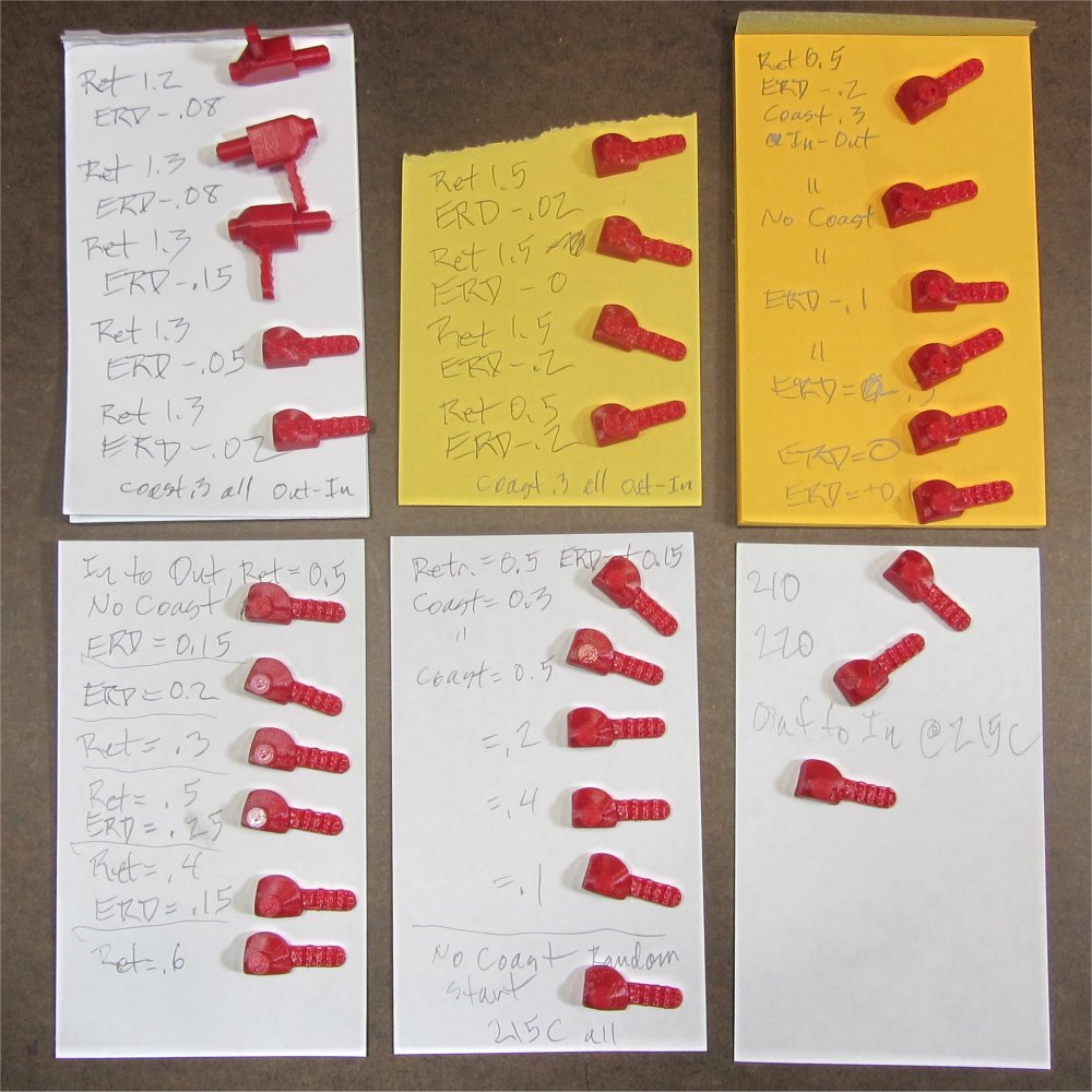

I'm printing some eSun PLA+ "Fire Engine Red" parts, and I'm having a hard time getting the print quality dialed in. I have done a fairly systematic sweep of a wide range of variables: temperature, retraction, extra restart distance, coasting, printing in-to-out & out-to-in.

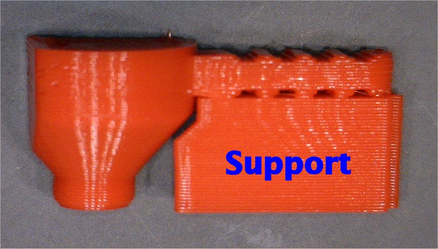

The part is small, with a conical section and an area off to the side that uses support:

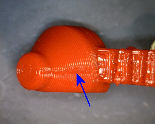

The problem is that I get a groove where the extruder leaves & returns from printing the support section:
The best I've managed is printing at 215C, with 0.5mm retraction, +0.15mm extra restart distance, no coasting and printing in-to-out. I can't tell if the groove is the result of under-extruding before it goes off to print the support, or when it comes back (or both...)

the grove is the Z axis change to the next layer. I have never gotten rid of it no matter what I have done. Orient your part so the the small part sticking off with the support is facing the back of the printer when you are facing the printer and the spool is on your left.
Then on the layer tab on the right side choose start point closest to specific location and enter X 100 Y 250.
With the part in the center line of the printer the Z change will be at the back end. Not s cure but sometimes looks better.
Let me know if you get it to go away and how you did it. Note if you have not calibrated your extrusion multiplier with a single wall square and digital caliper do so, as when properly set the grove is reduced. Also on the advance tab (assuming S3D) make sure only retract when crossing open space is checked.

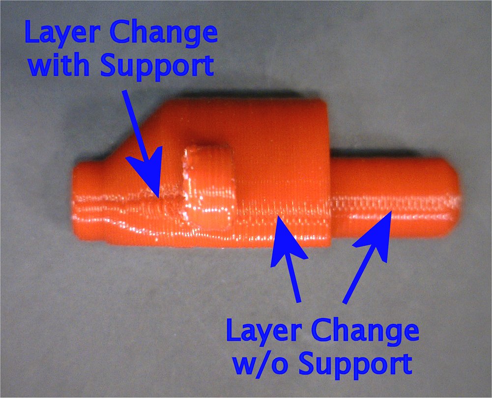

Actually, it isn't just the layer change. The layer change groove/line I'm used to, but there is a much larger defect when the layer change is combined with going back & forth to the support section:
As Ed pointed out, the pause between printing the regular & support section is longer than just going from layer to layer, which could be making things worse. However, it doesn't appear to be affected by the XY speed. If Ed's theory is correct, the higher XY speed should help, because the extruder has less time when it isn't extruding. Also, the distance between the regular & support sections is least where the defect is worst, which also implies that the problem isn't with the idle time between sections.
