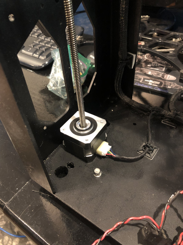

Ok so update.
I have completely dissembled the Z axis down to the motor and the ball screw rod so the motor will completely be unloaded. Cleaned the rod near the motor a long with applying a bit of lubricant. It seems like the motor pretty much behaves the same way. For each +10z movement the rod will spin in a random direction, and randomly get stuck. It seems like the problem has no bearing on the mechanical load or the motor being dirty. Any other debug ideas? More likely this is a problem with the motor itself or the electronics?
Here is what the setup looks like now along with the video of the motor going in random directions and randomly stalling:
https://youtu.be/A5jTIOBFRz8

So I got a little curious so I took the bottom of the motor apart and these electrical connections look suspect. Is this normal? The PCB traces look mangled and warped.
No sugarcoating: disassembling a stepper demagnetizes the rotor. You must buy a new Z-axis motor.
The motor is assembled with the rotor demagnetized, then it's magnetized in place. When you take it apart, the rotor smacks into the stator, which creates a localized high-density magnetic path between the rotor poles. The rotor poles can't support the high flux and demagnetizes.
You can put the motor together and it will "work", in the sense that the rotor will go around, but the decreased magnetic field reduces the torque for a given winding current. You can't increase the winding current, because the motor will overheat.
There's a conformal coating over the whole PCB to prevent corrosion, so what you see is perfectly normal.
