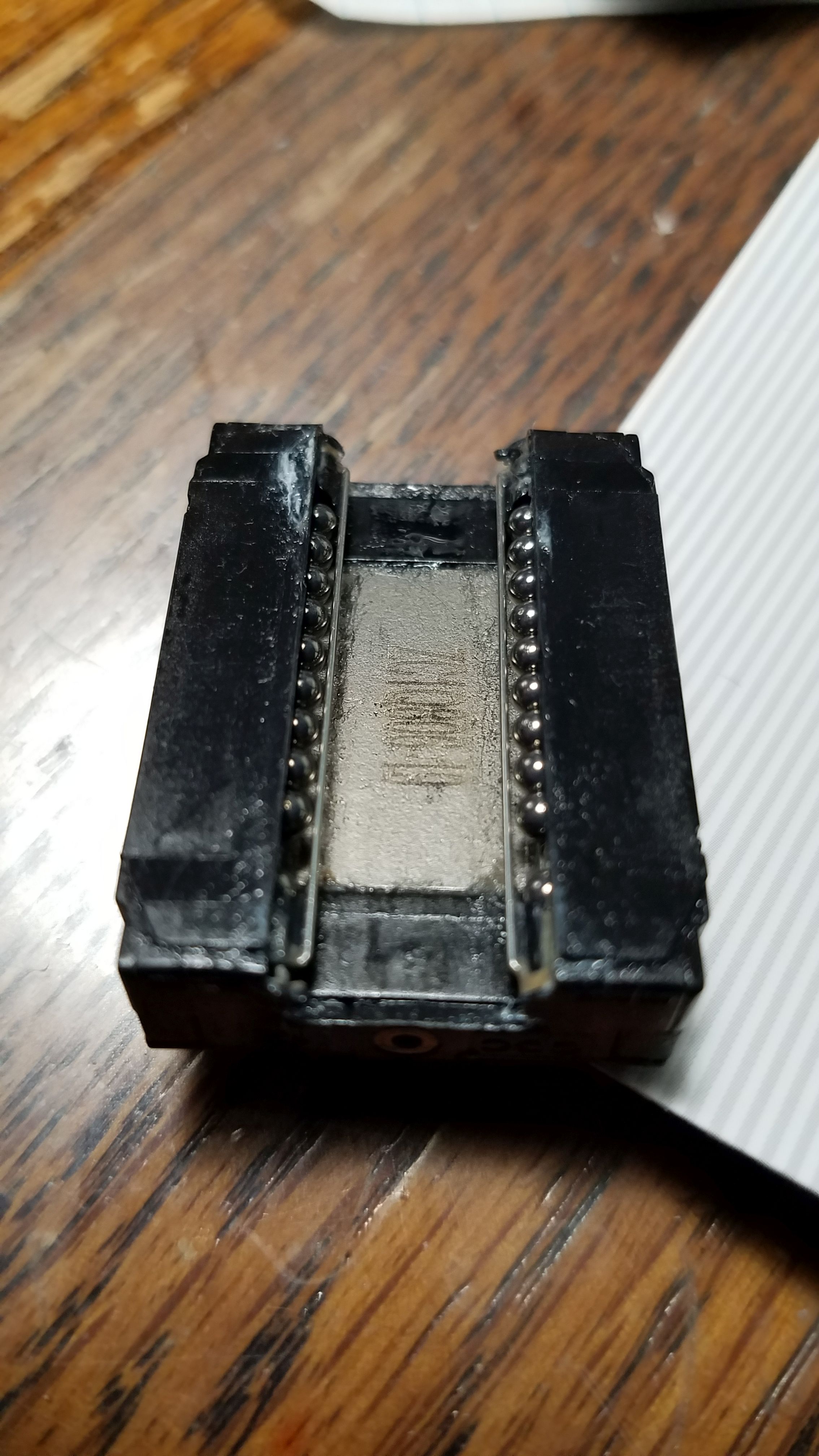

The bearing carriage (this is from my experience with an M2 Revision E.) is a :lol: recuirculator type bearing where the balls go around in a loop within the carriage. As long as nothing is broken insides, you can remove everything from on top of the carriage, take the ends stop off and slide the carriage off. Then carefully (over a sealed container so if the balls get loose you don't loose them) clean the carriage, tunnel and balls with solvent (I would use alcohol or paint thinner) some caned air and lube with 3-in oil, Resemble and see what you get..
