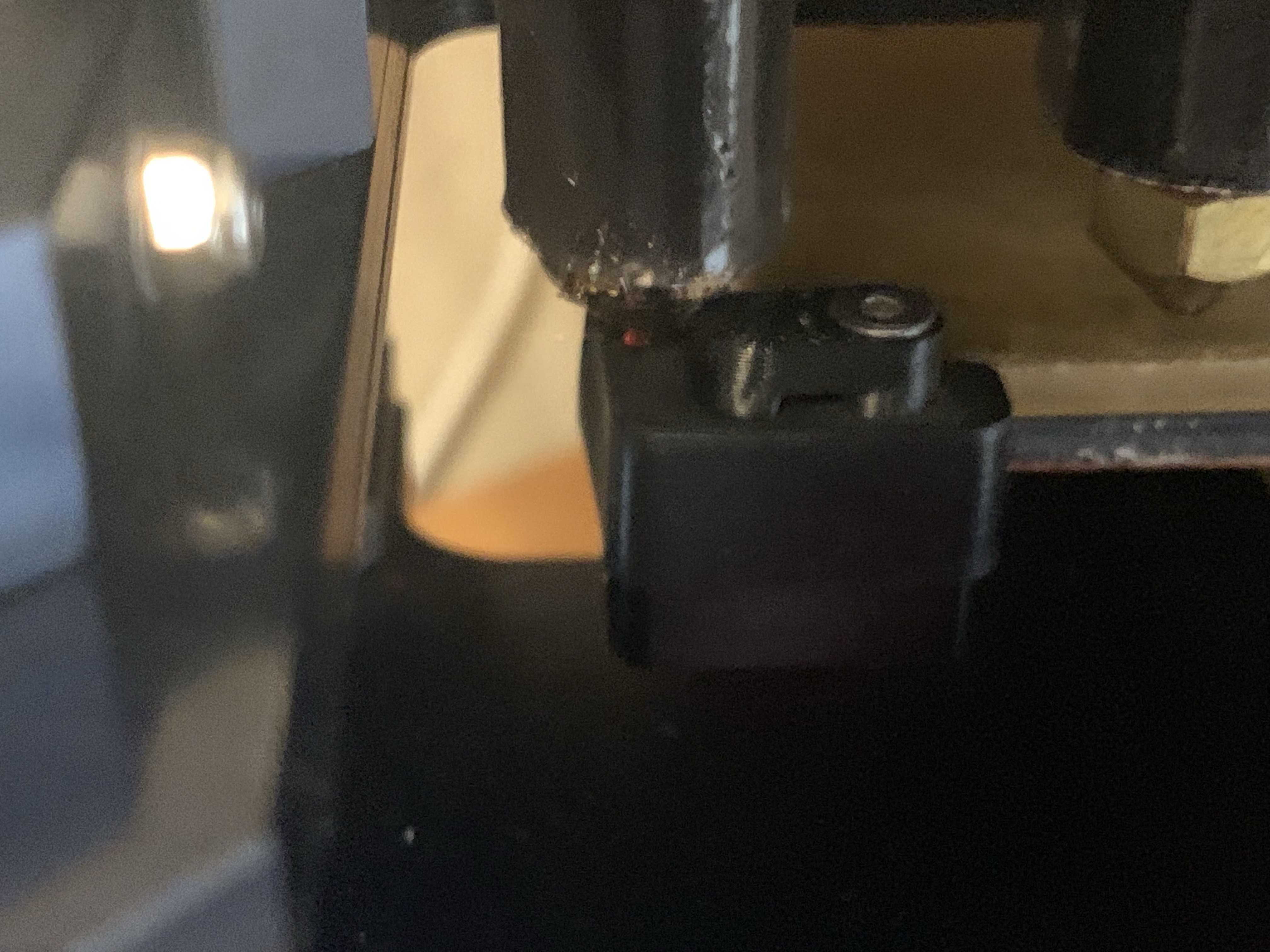

I checked my printer firmware origin today to see if 0,0,0 is in a printable area of the bed. I used the following G-Code
The results shows the print head off the bed and in the corner of the clip area. I suspect this is due to the roughly 31.1 x offset for a dual extruder setup.
Is this what allows the slicer, ie S3D to let me print outside the printable area. Ideally, I would like the firmware to keep me out of non-printable areas with the T0 extruder.
