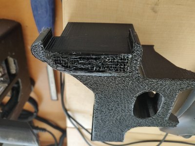

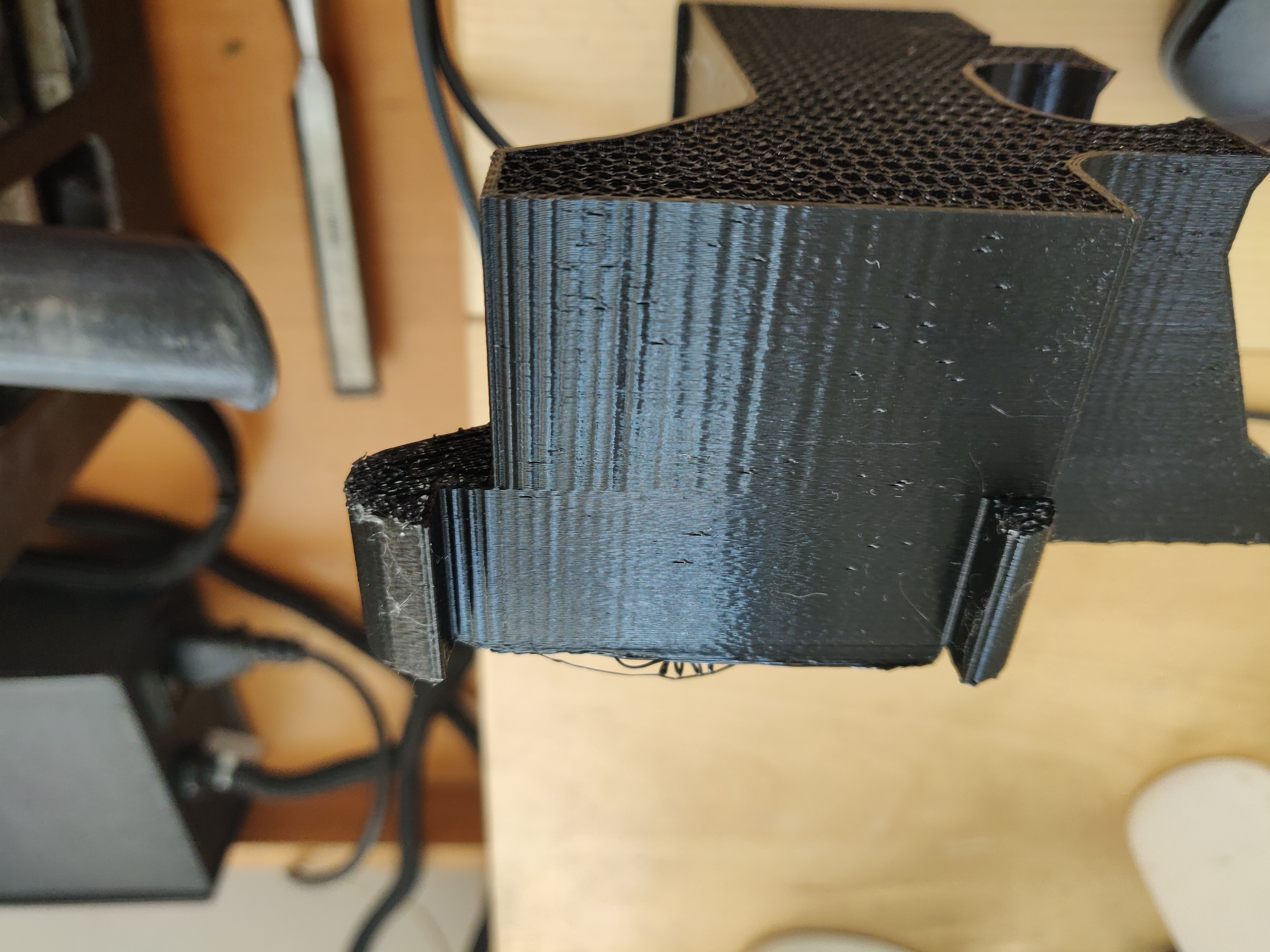

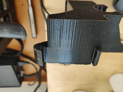

Hi guys
I got 2 questions referring 2 pics attached
1) what is the case of some waves shown in print ?
2) the wires that are printed on bottom side of the print ( i use raft in the print )
Regards Doron

Post by ednisley » Mon Jul 29, 2019 5:40 pm
sonra wrote:
Mon Jul 29, 2019 10:41 am
All of the surfaces and perimeter threads look like crap, so I'd check for an extrusion problem.
Have you calibrated the slicer's Extrusion Multiplier with the actual filament diameter and measured thin-wall square thickness?
Is the filament drive gear securely mounted on its shaft? A loose gear can cause baffling retraction problems, but the intermittent globs suggest there's something wrong with the drive.
Is the motor pinion driving the gearbox worn to a frazzle? You must dismount the gearbox from the motor to check, so do that when you check the drive gear.
If all that checks out, then some other problem may be in play, but it sure looks like extrusion from here.

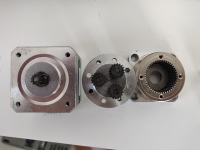

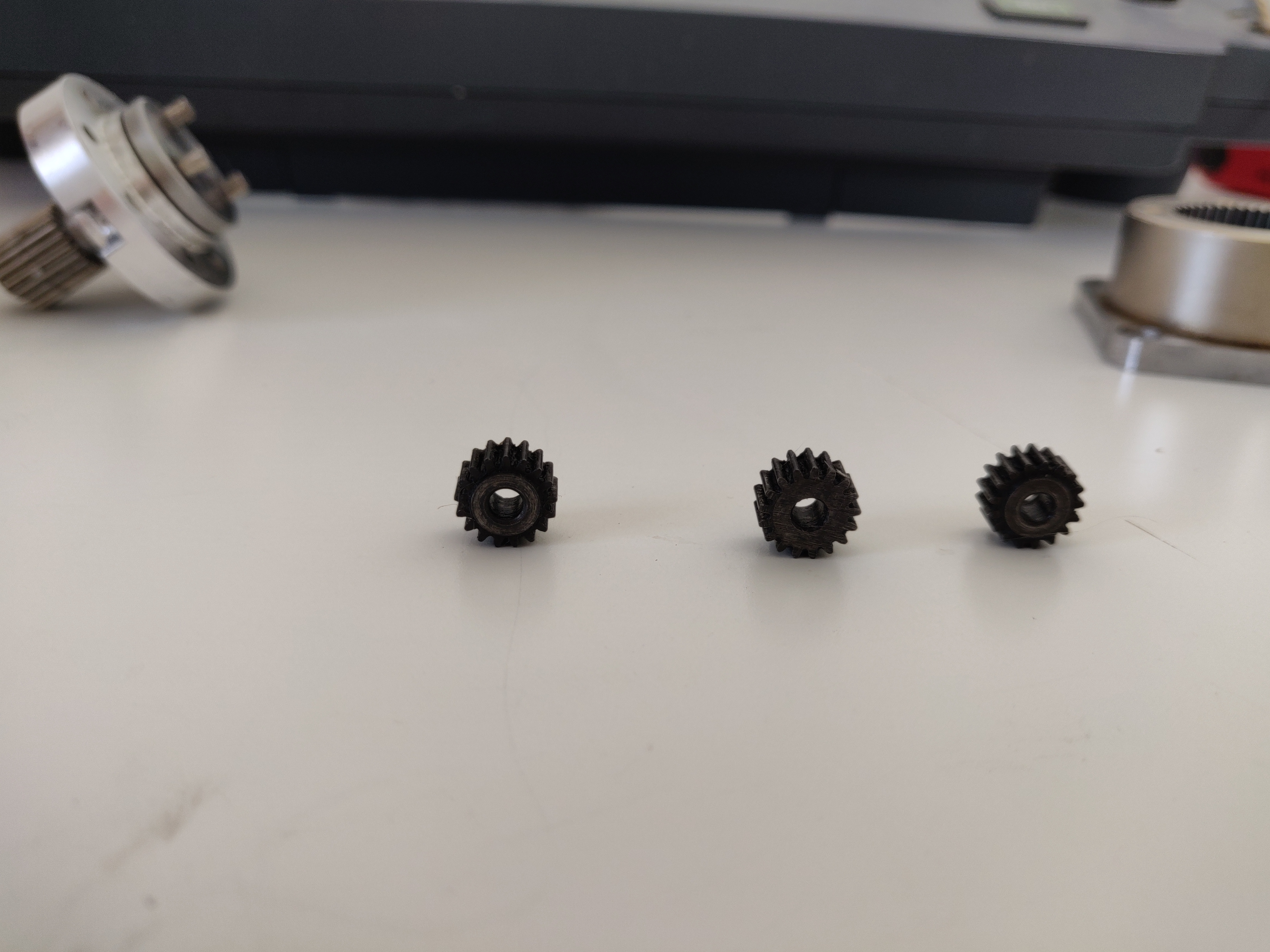

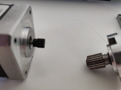

Hi
checked slicer's Extrusion Multiplier with the actual filament diameter and measured thin-wall square thickness and got the almost the some results for all walls (+-0.5 mm) is it good or not ?
Disassemble into parts the extruder motor I don't find any problem i attach pictures maybe you can see something I don't notice
Thanks ahead Doron
