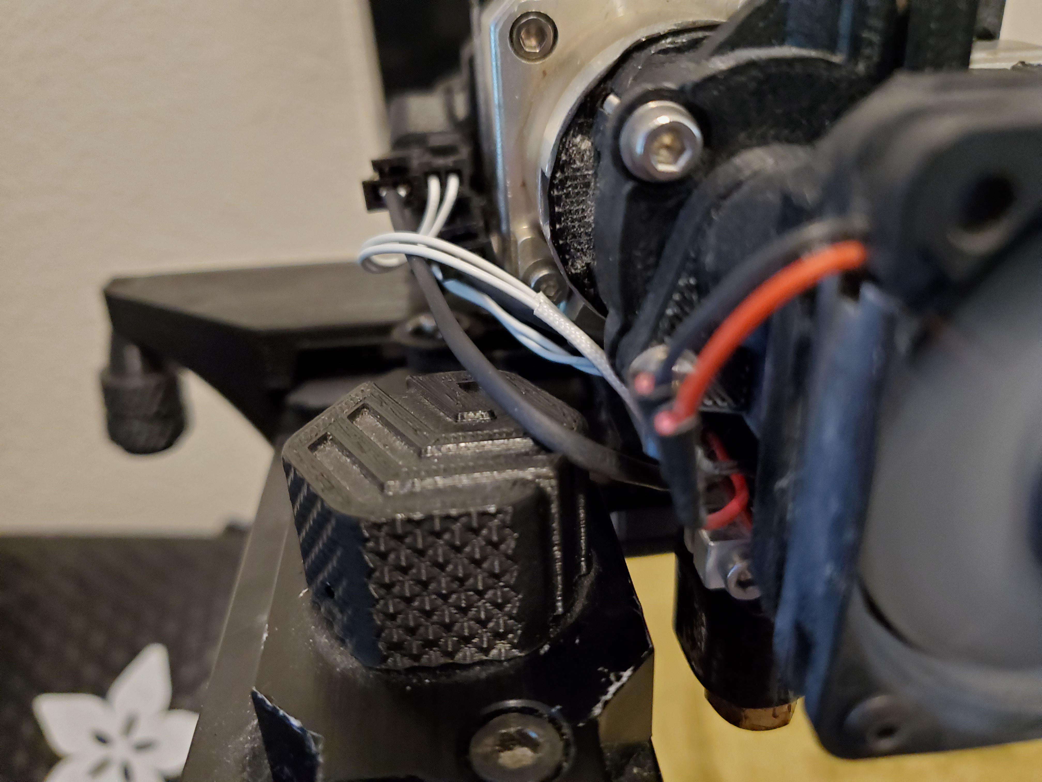

I appear to have made the mistake of not consulting Occam's Razor, but the problem is solved! I'll just leave a picture of the illusive issue. Thank you for all your help Ed!ednisley wrote: ↑Sun May 17, 2020 1:09 pmNow that I look at the source again, at least for (obsolete) Marlin 1.1.0, there's only one acceleration setting. Seeing as how homing works, it's probably OK.KaiborgStudios wrote: ↑Sat May 16, 2020 3:51 amaccelerations during homing to match that of jogging

what are we looking at????

Well, that's obvious! In retrospect, anyway. [grin]
The third item in the
Code: Select all
Debugging Rules poster
You did manage to "Make it fail" consistently, which got you most of the way to the goal.
Next time it'll be something entirely different, though …

I need myself one of those posters!ednisley wrote: ↑Mon May 18, 2020 1:59 pmWell, that's obvious! In retrospect, anyway. [grin]
The third item in theover my workbench applies: "Quit thinking and look". It seems I can always come up with a complex fault that doesn't actually match the obvious-in-retrospect evidence, alas.Code: Select all
