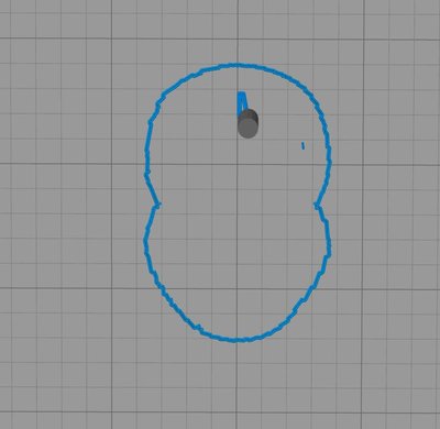

Prints are still not sticking down.
Re: Prints are still not sticking down.

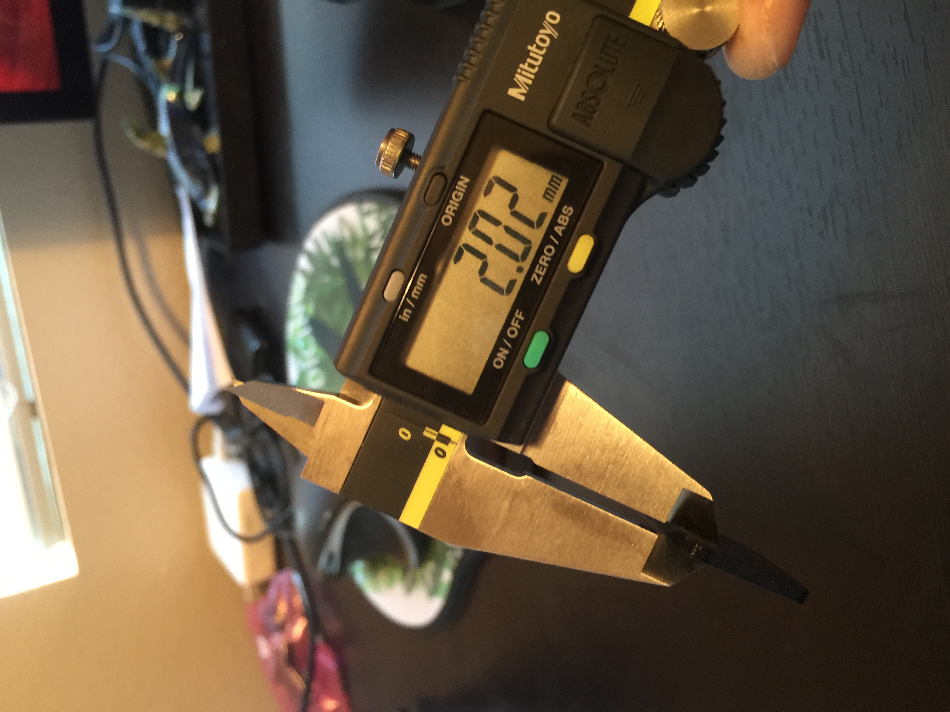

I did the test squares before each print and they both came out to 2.02.

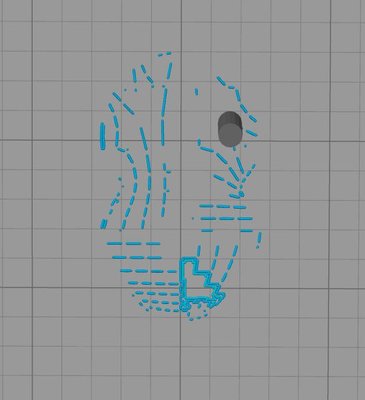

Okay, my apologies for not asking to see the model after your first post - i had assumed you were trying to print the T-Rex skull that you showed in your other pictures.
That skull pencil holder model is unprintable as it is. The first layer only has a tiny footprint in one spot - it's actually floating above the bed.
Layer 1
Layer 2
Layer 3
See how there is more on the second and third layers than on the first one?
Basically that messy squiggle that you keep seeing is what happens when you air print - but you are air printing because of the model, not because the gap is wrong. The only way to print that would be with a raft, because the bottom is not even. (at all).
In addition, you cannot print something like that with so many overhangs and cutouts without printing support underneath it. The support is going to be wider than the actual width of the walls, even if you could get it to print anything other than a huge mess, you would never be able to separate the support.
The walls of the skull in the file are too thin for a 0.35 mm nozzle as it is designed. Originally you were using 0.40 mm extruded thread width, and that was yielding walls that were too thin for a solid structure. So i tried to reduce the extruded wall width to 0.36 mm (the lowest you can go and get correct placement with a 0.35 mm nozzle) and did a slice. As shown below where the arrows are, you still do not have a solid structure.
So yeah, anything you print is just going to be a big nest of filament.
The only choices you have if you want to try to print that is to go to a smaller nozzle size, or re-design the file with thicker walls.
The good news is - it's not your printer. That is set correctly, and shouldn't have any trouble with other files.

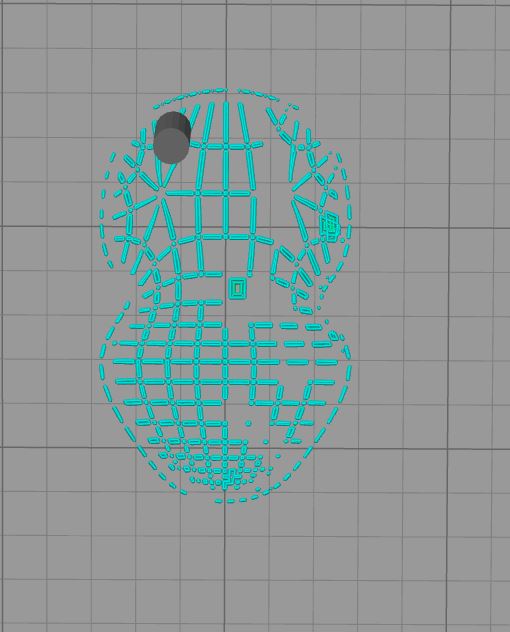

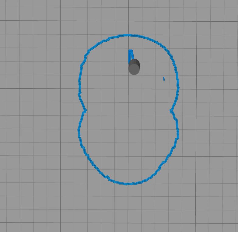

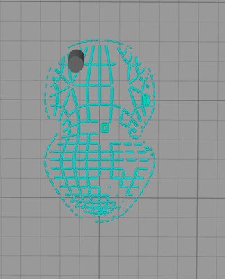

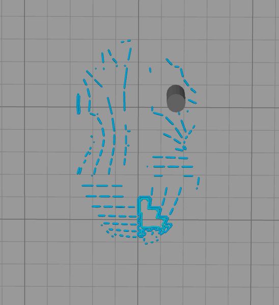

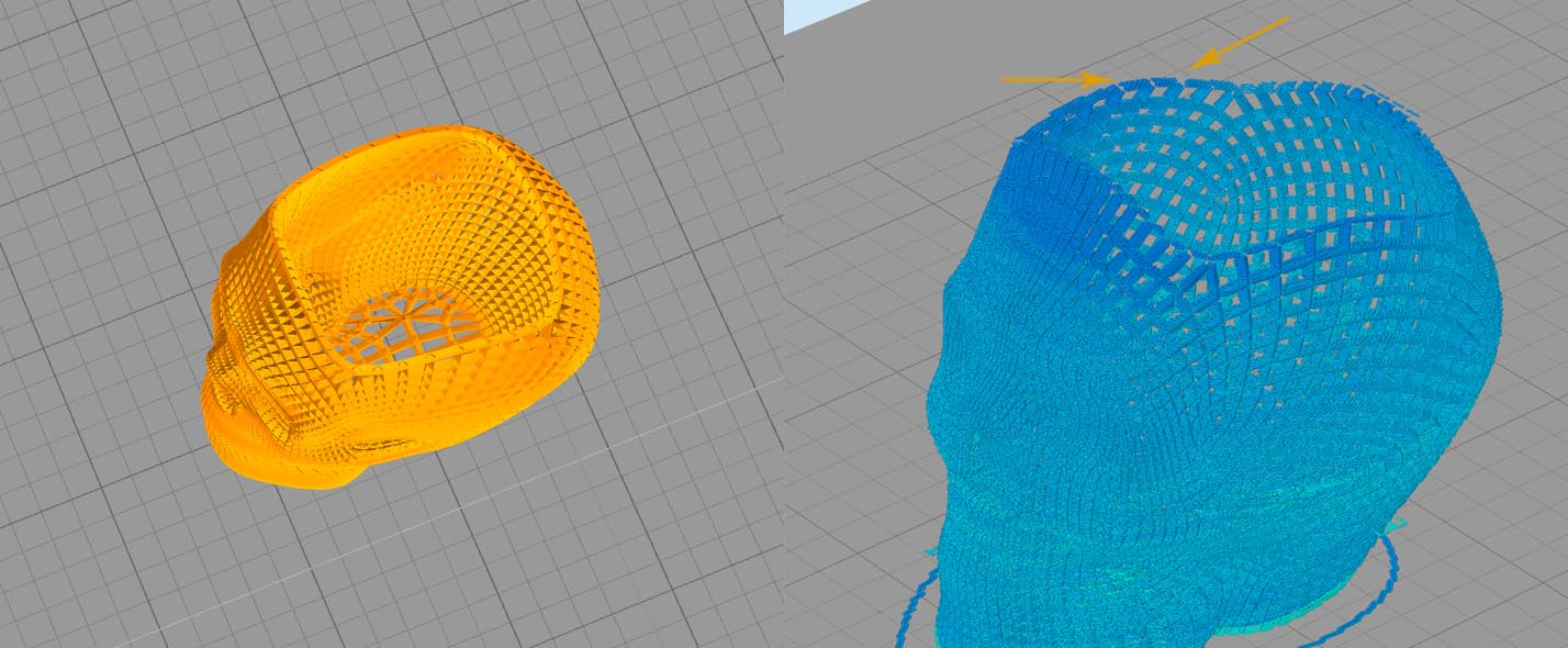

Layer 1
Layer 2
Layer 3
