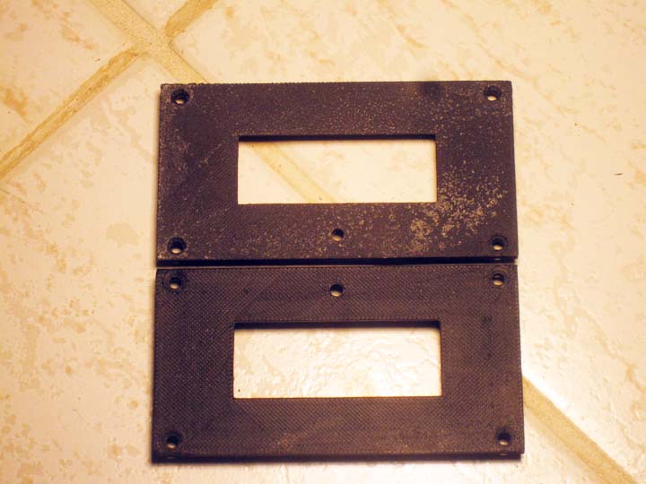

This is a comparison of the same print and temperature settings. The top used the standard plate. The bottom one used my glass plate. Both items came out without warping. The discoloration is the hairspray that adhered to the print.

That is why I use elmer's glue sticks for ABS printing. It holds better than hair spray and washes right off.
I like the finish of your glass better. How about a picture of the glass.

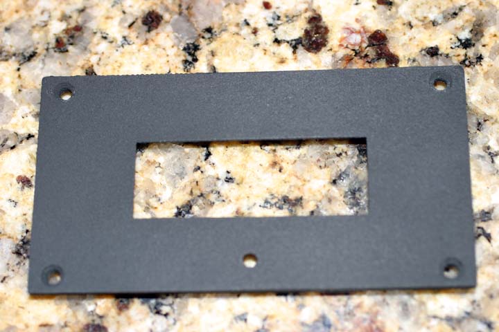

Here's my finish for the top piece

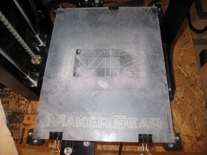

jimc wrote:For alum you should get mic6 tooling plate. Its cast and stress free so it stays flat when its heated and cooled. You can get it from mcmaster or online metals. Its machined on both sides. You will need to find someone with a blast cabinet to glass bead it for you and cut to exact size
I got my piece of mic6 tooling plate it is 10 X 10 ¼” what is the best way to cut the 2” of the one side.
I have a 12” chop saw?
Then I just have to find a place to glass bead it maybe a machine shop?
Re: ABS printing surface
Post by jimc » Tue Sep 16, 2014 3:19 am
Yes thats fine as long as it has a nice 80 tooth or better carbide blade. They do make special saw blades for non ferrous metals but just to make one cut youll be fine with your saw. Many places have blast cabinets and many medias will work, not just glass bead. You just dont want a real coarse media. A nice fine aluminum oxide will work as well. Just tell the person you dont want a rough surface. I actually used a very fine crushed recycled glass.
