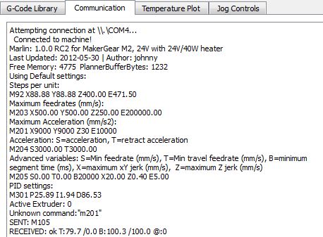

I am just now getting back to this. I believe my settings are a bit high.
If I am reading this correctly the xy acceleration can be as high as 9000
but the m204 sets it to 3000. And since the z is set to 30 max it will still be 30

send M204 S1000 to the printer. this will change the acceleration. if you like it at 1000 then send M500 to make it permanent or you can put that m204 command in the start script of your process so you can change it with your print.

Thanks JIm I tried that Last night. worked ok but it was a small print.
Ill print one I have been having problems with. Just putting off going back to 1/8 steps. I always get edgy updating firmware.
