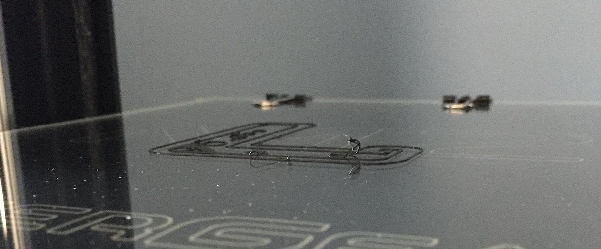

I tried printing an M2 tool holder from Thingiverse a little while ago. First layer ended up like this...

The picture you showed indicates that the gap is too large between the bed and the nozzle. I'll give some tips for that and the retraction issues in the write-up. :D
