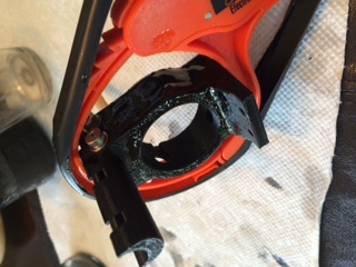

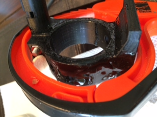

Wow, Toby - I think that would work. It doesn't really have to be strong, just stay intact and hold it's shape. I will try it as soon as I get my printer back up and running. The extruder motor mount has cracked.
Re: Need help with printing tiny parts
Post by Tim » Sat Jun 07, 2014 3:54 pm
Hmm, now where have I heard that before?
I fixed mine with 2-part epoxy and I'm still using the same mount.
Post by jimc » Sat Jun 07, 2014 5:08 pm
if your mount is cracked, its abs so solvent bond it back together long enough to print a new one to replace it.

jimc wrote:if your mount is cracked, its abs so solvent bond it back together long enough to print a new one to replace it.
Too late! I've smeared epoxy all over it! I thought is was PLA. Oops! Bonding it would have been so much easier. Anyway, I hope this will make it long enough to print a new one.
Post by jimc » Sun Jun 08, 2014 2:18 am
all the plastic parts on the m2 are abs. they need to be because of the heat. once you get the mount squared away do yourself a favor and just print yourself out a spare of everything just in case
