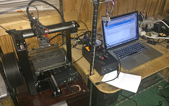

- Ready to go..soon
- setup.jpg (65.19 KiB) Viewed 88572 times

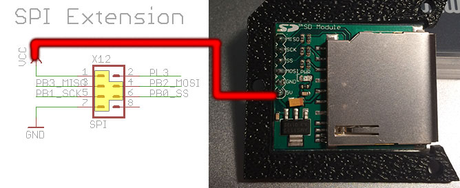

I think I have worked out the SD card wiring issue. I looked at the RAMBo schematic from http://reprap.org/wiki/Rambo and the re-opened the SD holder to look at the SD reader pinouts, which were thankfully labeled.
So, the red wire should be installed on the same side as the USB plug. I checked the wiring out and still got the "SD init fail", but then I inserted the card and it fired up and I could read and execute files from the MCP window.
I mashed up this photo with the schematic diagram to show the plug, wire, and connections:
