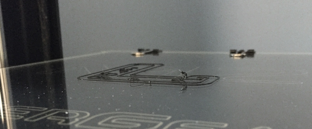

Post by jsc » Wed Sep 16, 2015 2:52 am
What do you mean you have a few mm stuck up in the air? Can you take a picture?
Is a piece of filament that has been laid down coming up? You need to do something about bed adhesion then.

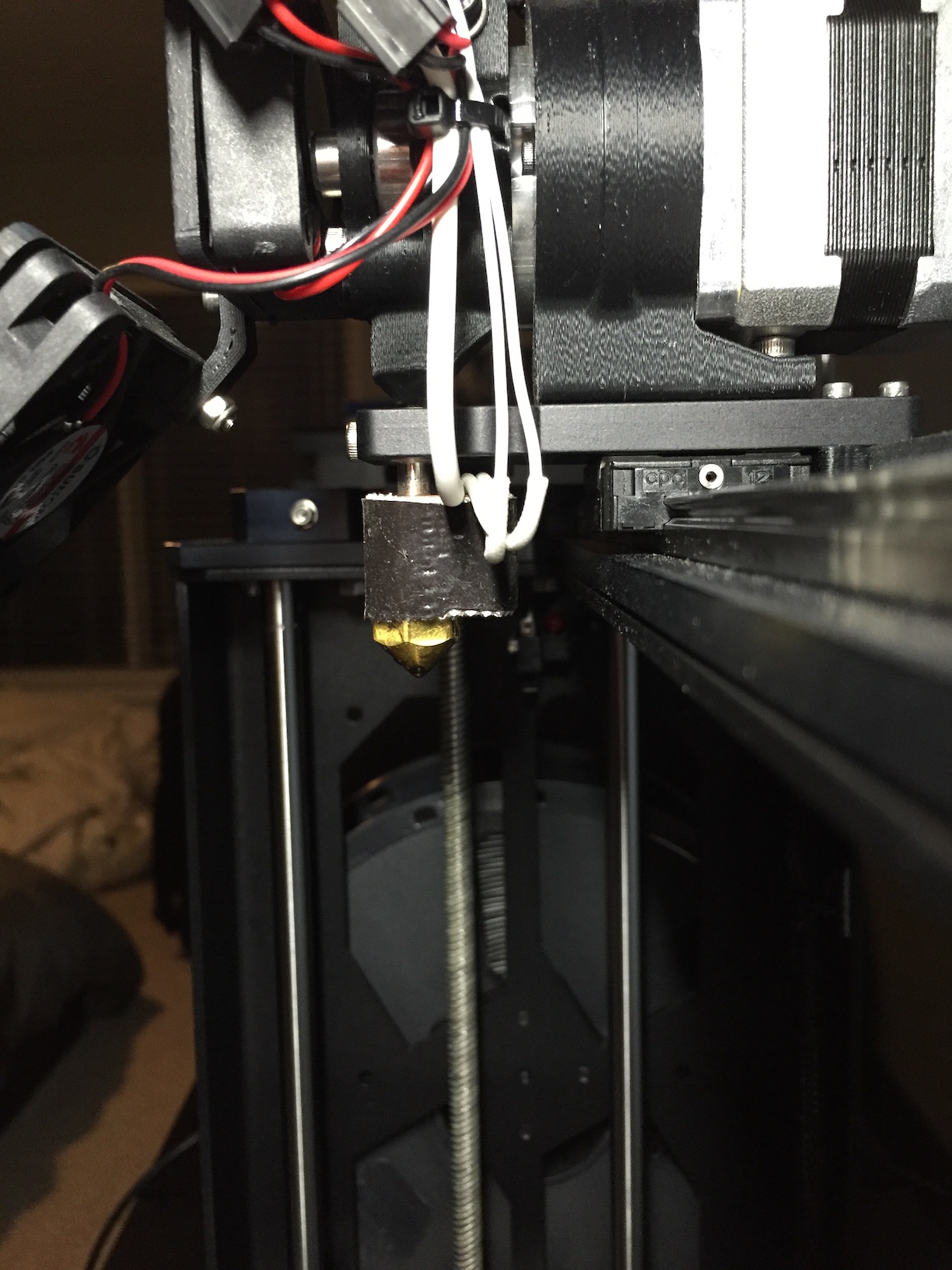

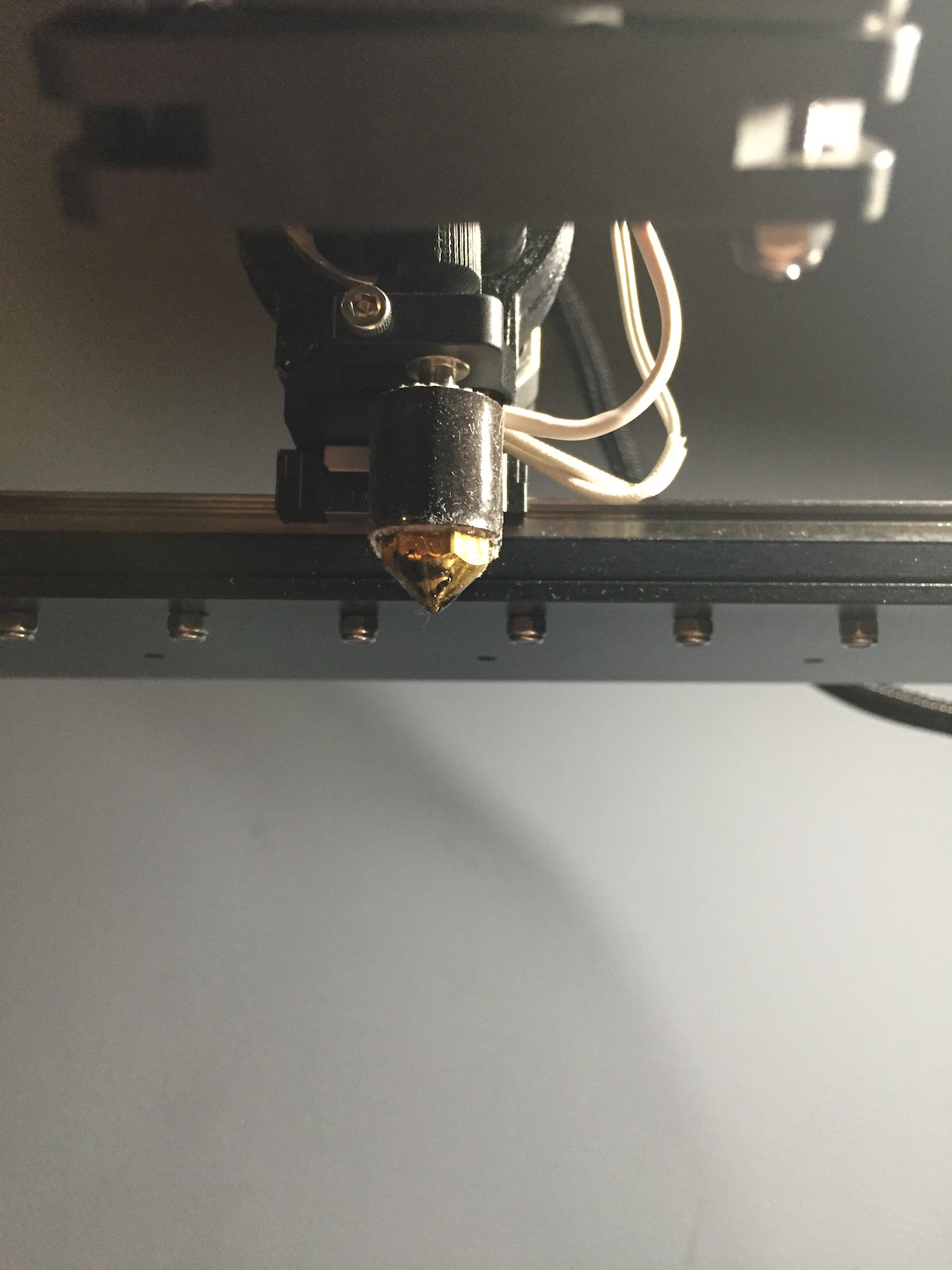

Turn off the machine. Pull the little black rubbery cloth thing off of the heater block. The thermistor and heater wires need to be sticking out to the right, as you face the machine. If they don't, loosen the screw slightly, without letting the nozzle fall out, and rotate it until they do, and the heater block runs parallel to the metal holder above it. Tighten the screw and put the cover back on.

Post by minusbacon » Thu Sep 17, 2015 1:27 am
Jules wrote: Turn off the machine. Pull the little black rubbery cloth thing off of the heater block. The thermistor and heater wires need to be sticking out to the right, as you face the machine. If they don't, loosen the screw slightly, without letting the nozzle fall out, and rotate it until they do, and the heater block runs parallel to the metal holder above it. Tighten the screw and put the cover back on.
Seems right to me, but I'm new at this. ;)

Pretty sure adhesion isn't the problem. The pieces that stick up haven't even been laid down. Here's an example...
This happens when it stops extruding to move the head to another area of the print. The piece doesn't get laid down properly. This happens regardless of end temp, bed temp, extrusion multiplier, or print speed. The stranger thing is it only happens most of the time. Monday I had two basically successful prints. Tuesday I tried printing one of Monday's successful prints again using the exact same settings I used Monday. Tried the same object four times. Each one had pieces like this up in the air.
