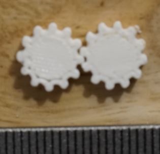

Amazingly, the gear printed even better than my larger test case:
The ruler marks at the bottom are in mm, so the diameter is about 6 mm, and each tooth is under a mm.
I seem to remember little gears like that from some kit or other when I was a kid. Looks and feels exactly like them.
Edit: I just realized, you said the gear was 7mm across, and it shows up as 6 3/4 in S3D, but as printed it really is under 6 mm. That suggests it might be helpful to scale it up by 10% or so in X and Y before printing.

That's so small that every movement of the machine counts---for instance, the seam at the right side makes one gear tooth significantly larger than the others. But then the piece is so small that the total number of instructions in the gcode is small enough that the gcode can be tweaked by hand. It's one thing to say that the gear looks nice, but it's quite another thing to put it on an axle and try to reliably engage another gear with it.
Re: Need help with printing tiny parts
Tim, I see your point. I hadn't noticed that bulge. Unfortunately I don't have the mechanical intuition to know if it would work as a gear or not.

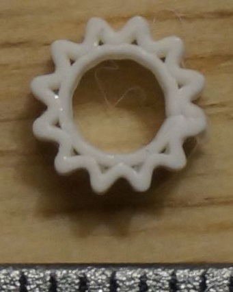

I tweaked the settings a bit in an attempt to improve it. I tried to trick the nozzle into behaving like a smaller one by setting the nozzle diameter to .25 and the extrusion width to .25. Also, I turned on random start points for the perimeter. Here's what I got:
This is 10x actual size. I scaled the original model by 5% trying to compensate for whatever was making it print smaller. This one came out about .5mm shy, which I think is mostly just missing tips of the teeth.
The gear is too small to test by hand, but rotating two of my slightly larger gears against each other they appear to mesh well:
Attached is the latest .factory file, which includes my test gear, the scaled 7mm gear, and the new settings for PLA.
