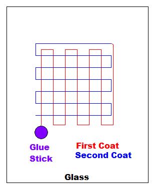

Get a Elmers Purple glue stick and with the bed cold lay down two light coats just where you are going to print following the pattern below...
The first coat go up and down and the second coat go side to side, do both coats in one continuous stroke without lifting the stick. Lay it down light, the glue stick is purple but it should go down clear, if your laying it down and it's laying down purple your putting it on to thick. (Just keep in mind when using a glue stick for adhesion never force the print off the bed, just let the bed cool and it will pop of by itself. (Cracking sound is normal... be patient.)
