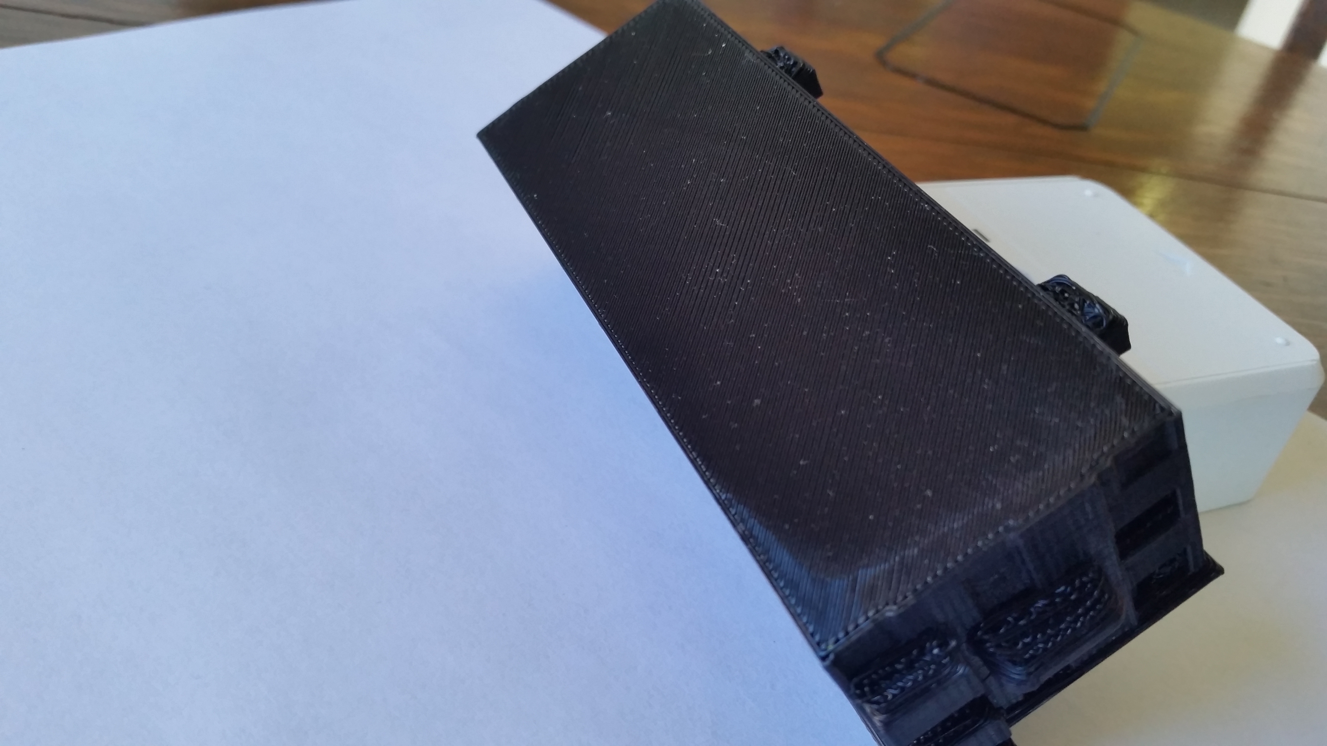

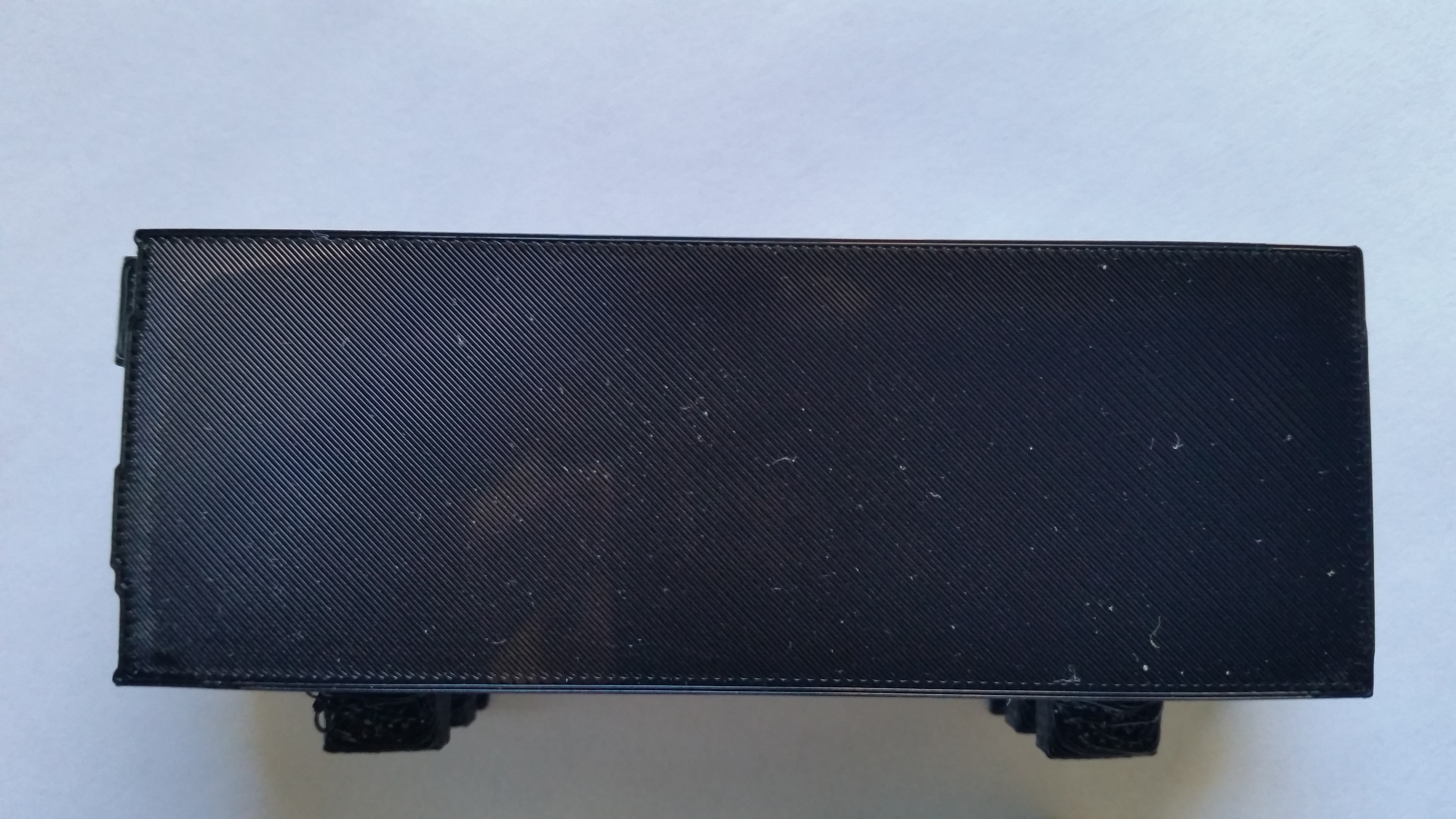

After all the changes the corners are still pulling up. I'll run the bed wizard now.
Maybe hard to see in the photo, but all four corners are are as badly warped.
But it seems like this isn't a bed leveling problem since all four corners of the model are pulling up right?
Maybe I'll try to the blue tape, I just don't like the idea of it ripping off in little pieces and having to reapply it so often.
Other than that, where do I go from here. Getting frustrated.

Re: Prints pulling up at corners
your still way too far from the bed. you have no bed contact there. you can see between every extrusion line.
Yeah, it looked that way to me too, but then when he put the tape on the glass, it narrowed the gap. He says it's finally sticking in his last post. (Was going to wait to see if it still warps up on the tape.)jimc wrote:your still way too far from the bed. you have no bed contact there. you can see between every extrusion line.
But you're so right....it's all about the gap. Before he put the tape on the glass, it was still too far out. (By about the thickness of the tape, guessing about 0.10 to 0.15 mm.)
If he starts using a Zebra plate, it's all going to need to be re-set anyway, so i figured, since he's got it working now, it should be good enough for a few days until the plate arrives.
