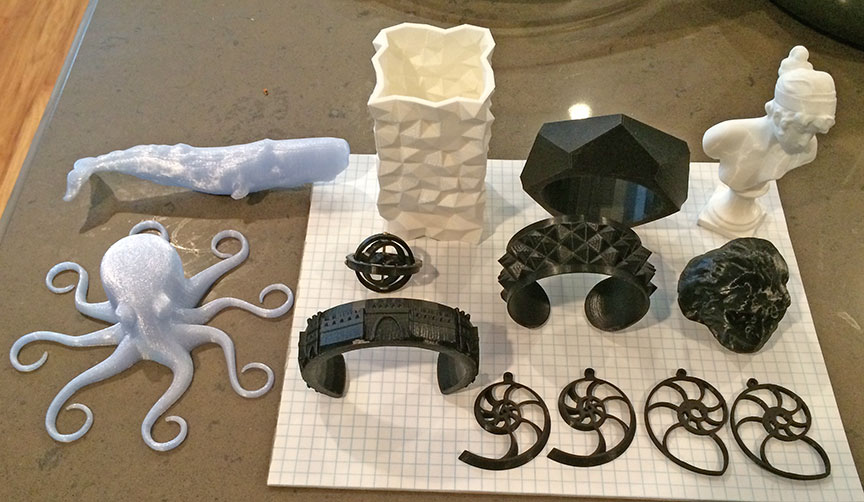

Here are some recent examples of prints posted on this forum by other members:
From
This is from a new user (Will Newton) posted in his thread on assembling the M2 for the first time:
viewtopic.php?f=8&t=9&p=1015#p1015
This thread recently appeared.
viewtopic.php?f=6&t=146

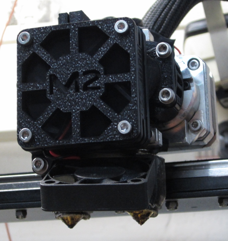

Makergear is working on an all metal dual extruder. Below is a pic they posted recently in the old Google Group. (In this thread but there's no other useful information besides the picture:
https://groups.google.com/forum/#!topic ... BljKMuzlBA )
Dual V4.jpg (296.35 KiB) Viewed 31477 times
