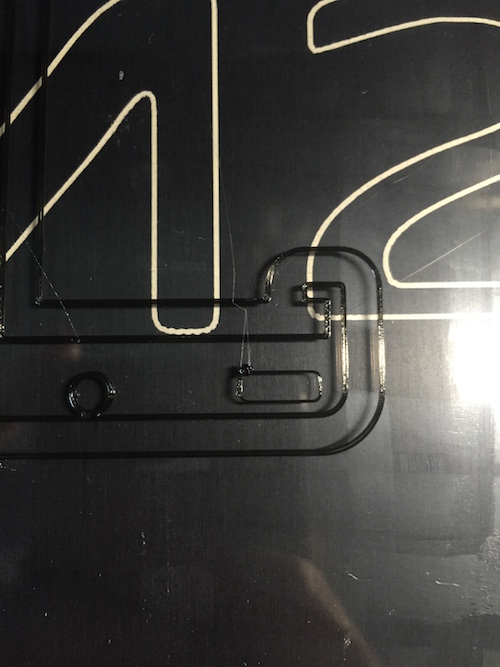

First attempt printing the tool holder after applying glue stick to the bed...
You can see where the filament gobbed up and/or didn't lay down. Sooooo..it's not bed adhesion. What next?

More glue stick. You will notice that your latest print looks a lot better than your first. Apply the glue stick over the whole surface, leaving no areas bare.

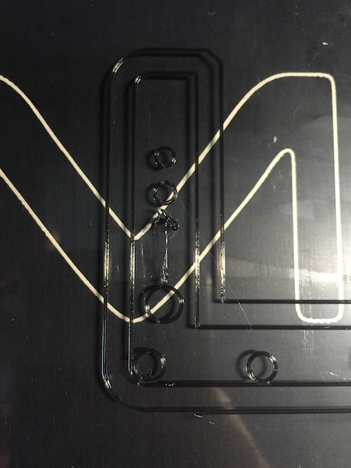

I just did that and tried printing the same part again. This time it started the skirt but wasn't laying down any filament. Was basically just making a line in the glue. I didn't apply that much either. You can see there's glue there but its not purple or anything.

Put a thicker coat of glue on the glass and let it dry completely. (No purple.) Make sure that you have the thick layer of glue all the way out where the skirt is printing.
Heat the bed up to 60°C before you start your print.
Slow down the first layer speed to 50% of whatever you are using for the regular printing speed.
If you don't get it to work with the glue stick doing those three things, go buy a can of hairspray. (It's easier to apply evenly and thickly than the gluestick.)
