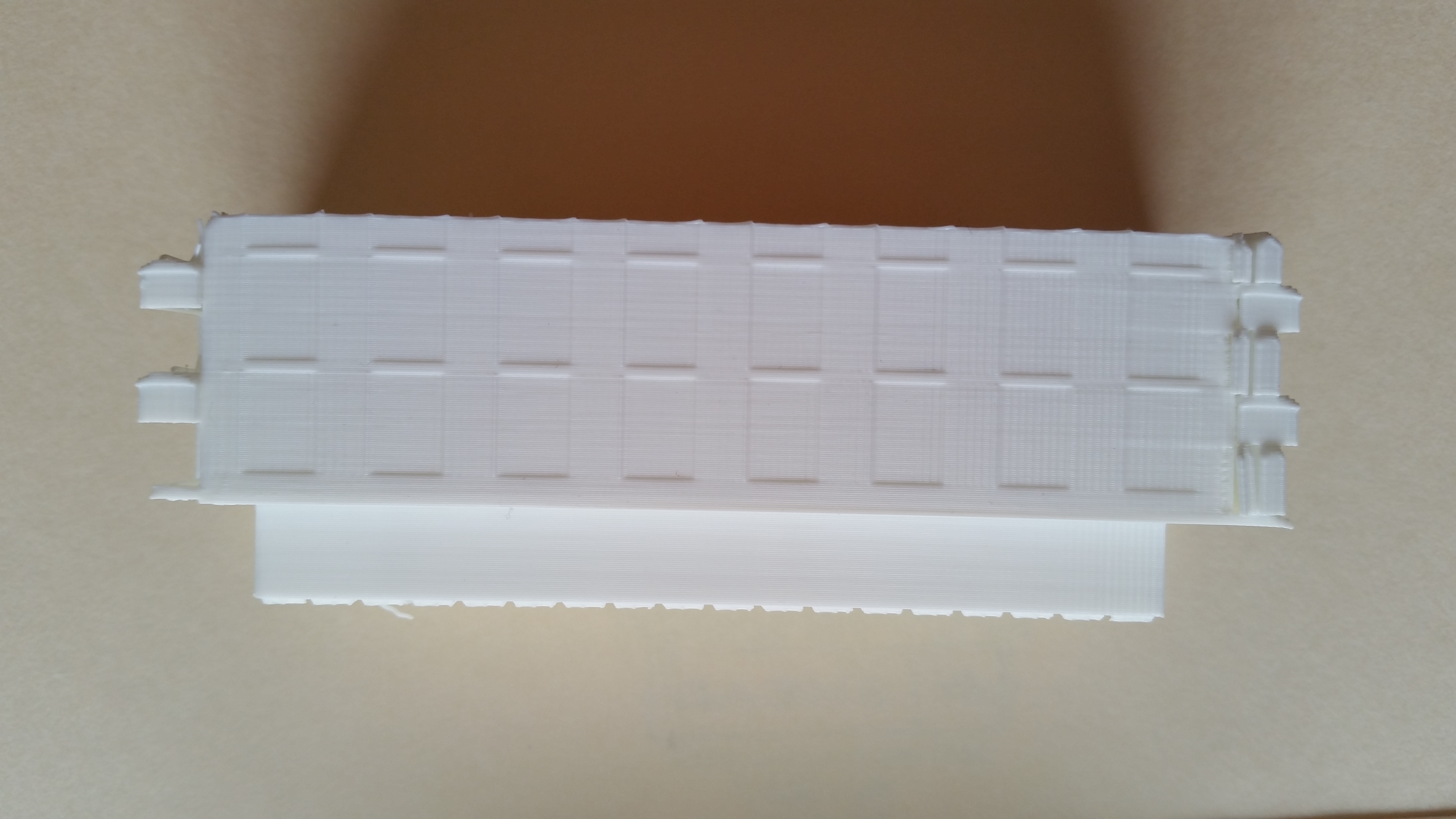

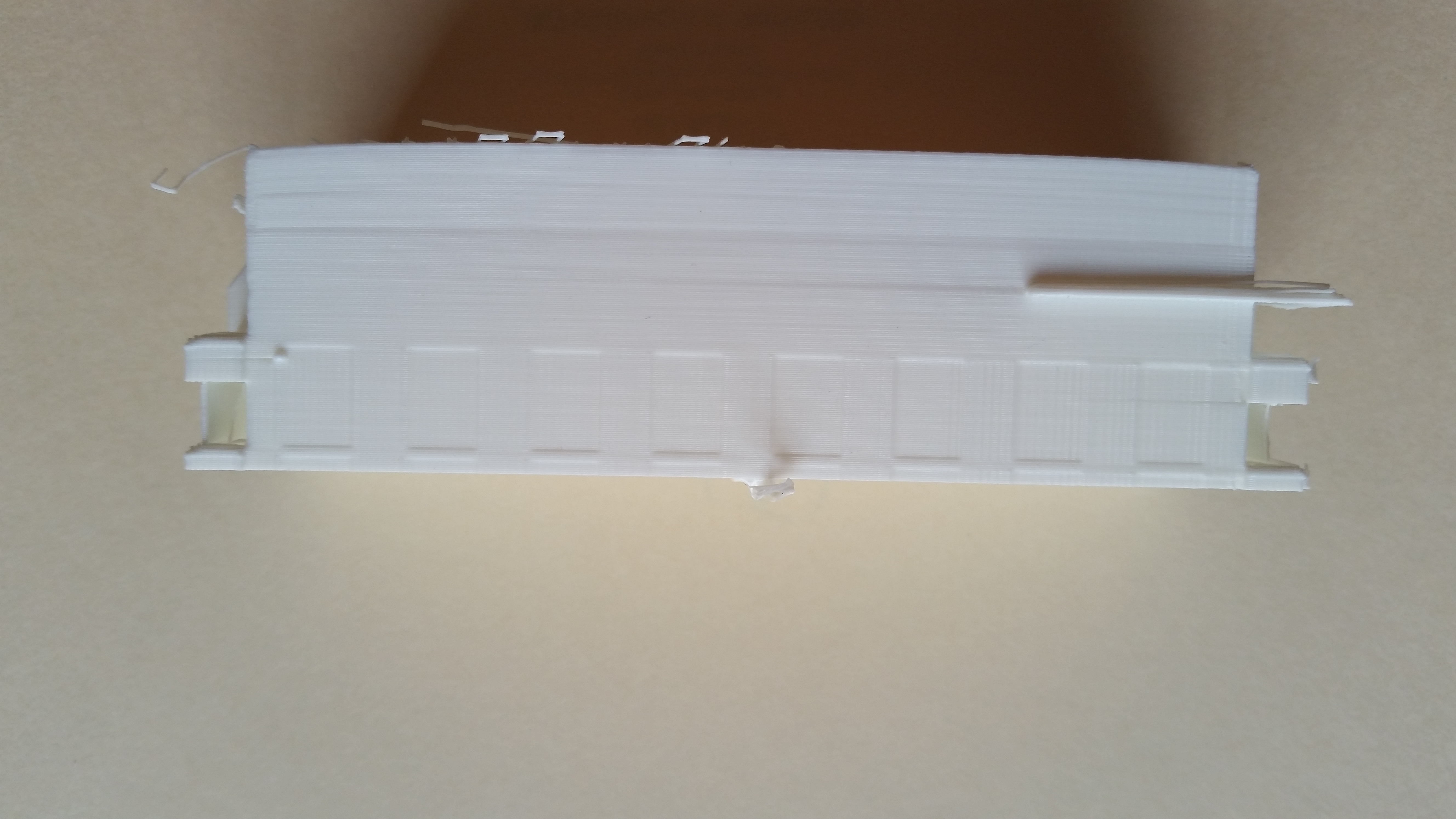

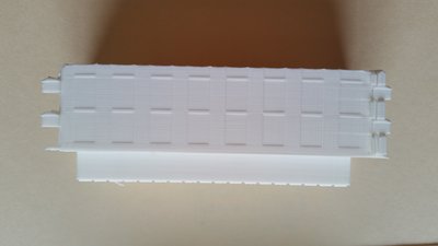

I spent a few ours leveling the bed. Thought I had it down perfect. Lowered the zstop so that first layer is going down fairly squashed and sticking great. I'm printing a building bc I'm on a deadline and it has to be done asap. I'm using a raft and everything is looking great. Raft is sticking, building doesn't look warped. But then later on when I peel off the raft, the building looks a bit warped. Do I need to let this thing cure for a while? I wait at least 20 min to peel off raft.
I have to print this building in two parts, because it's too tall, and I'm worried the seam will be noticeable with the warping. Guess I can print a little extra and then sand down a layer to make straight. Any ideas?

the tops of those photos are should be flipped 180 degrees. The tops in the photo are the bottom where warping are.
