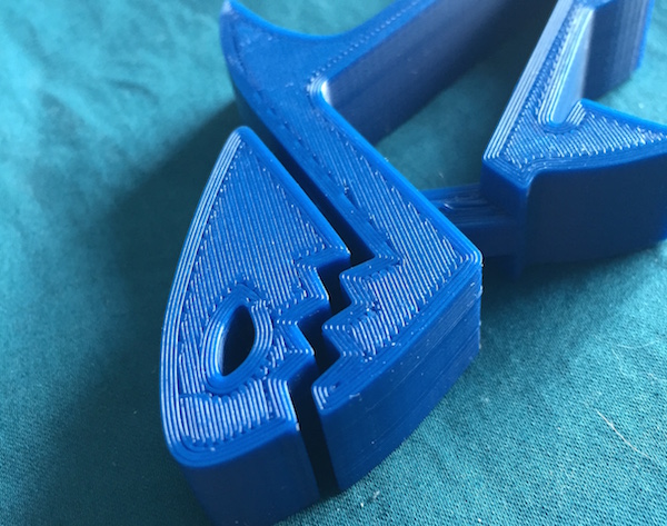

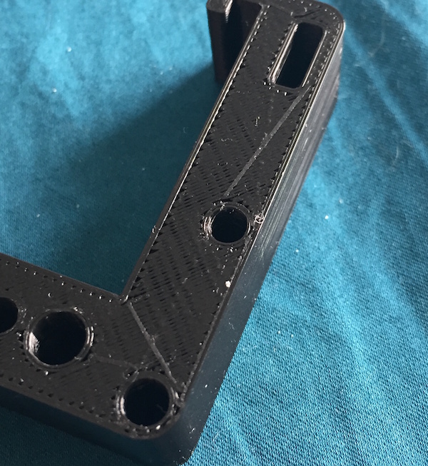

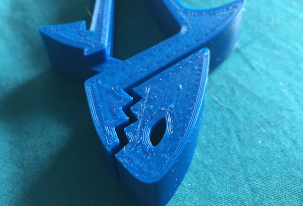

Post by minusbacon » Sun Sep 20, 2015 5:15 pm

Bottom layer for reference.
Top layer. It's not bad or anything. Just not as smooth and clean as the bottom layer. Would be nice if there's a way to smooth the last few layers out when it's printing. Slower speed maybe? Or is finishing (sanding, filling in gaps) after printing the only way?
What are those lighter lines in this print? I see it happen from time to time at random. It happens when the nozzle is moving while not extruding. I'm guessing it's the nozzle touching the part while it's moving? It doesn't happen often and I just went through leveling and setting z offset. So if all that is set properly, why would the nozzle be able to contact filament it just laid down?

Post by jsc » Sun Sep 20, 2015 6:04 pm
That's just what the top of a 3D printed object looks like. Sorry. There are numerous threads around in the printed objects forum, usually by jimc, of some gorgeous finish work. Sanding doesn't really do a whole lot for raw PLA; the two best things I've tried so far is high build automotive primer, then sanding (for looks), or XTC-3D, a thin two part epoxy by Smooth-On intended for 3D printing (for a sturdier finish).
If you print a small part in ABS, you can smooth the whole thing over with a brief wash of acetone, or immersion in acetone vapor (may be hazardous to your health): https://groups.google.com/forum/#!msg/m ... rlfqyhsPIJ It tends to give everything a slightly melted look.
Have you done an extrusion calibration? You may be over extruding slightly, leaving the surface just high enough to leave tracks through it when moving. A quick fix, though, is to add a small amount, .10-.20mm, to Retraction Vertical Lift under the Extruder tab, which will raise the extruder for travel moves.
