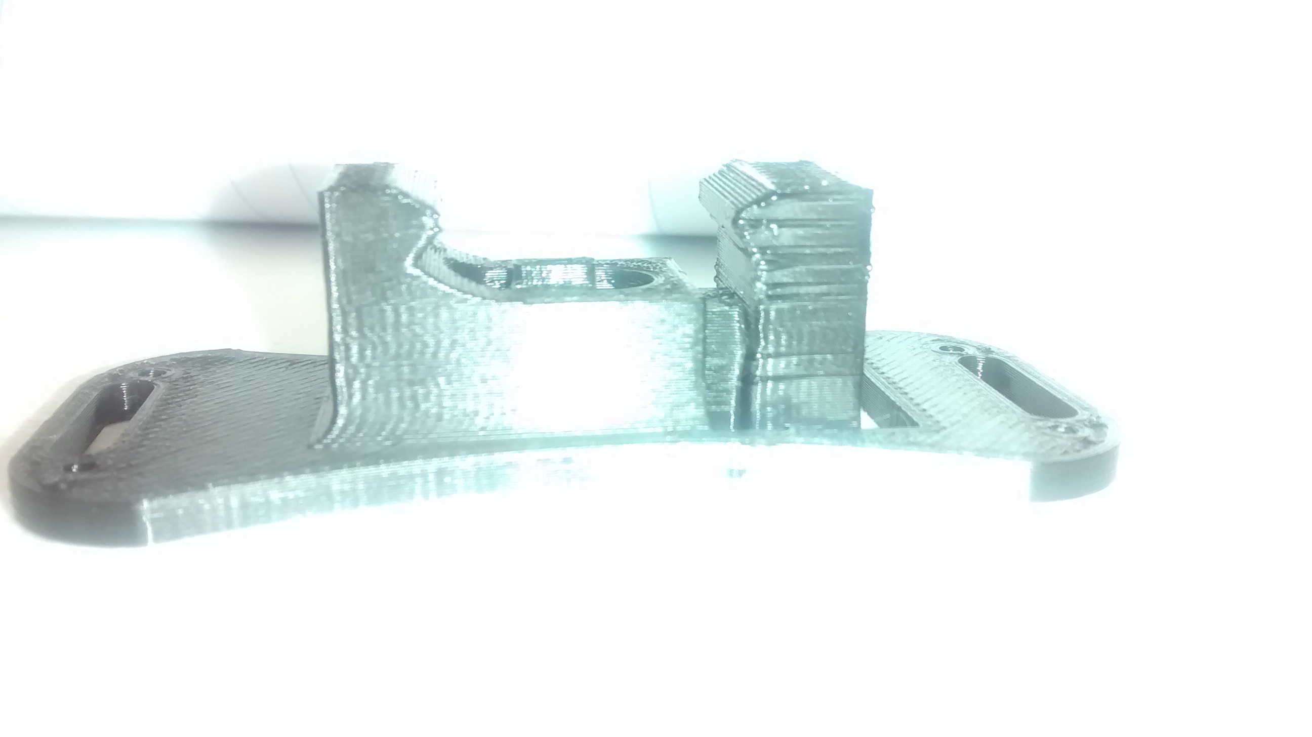

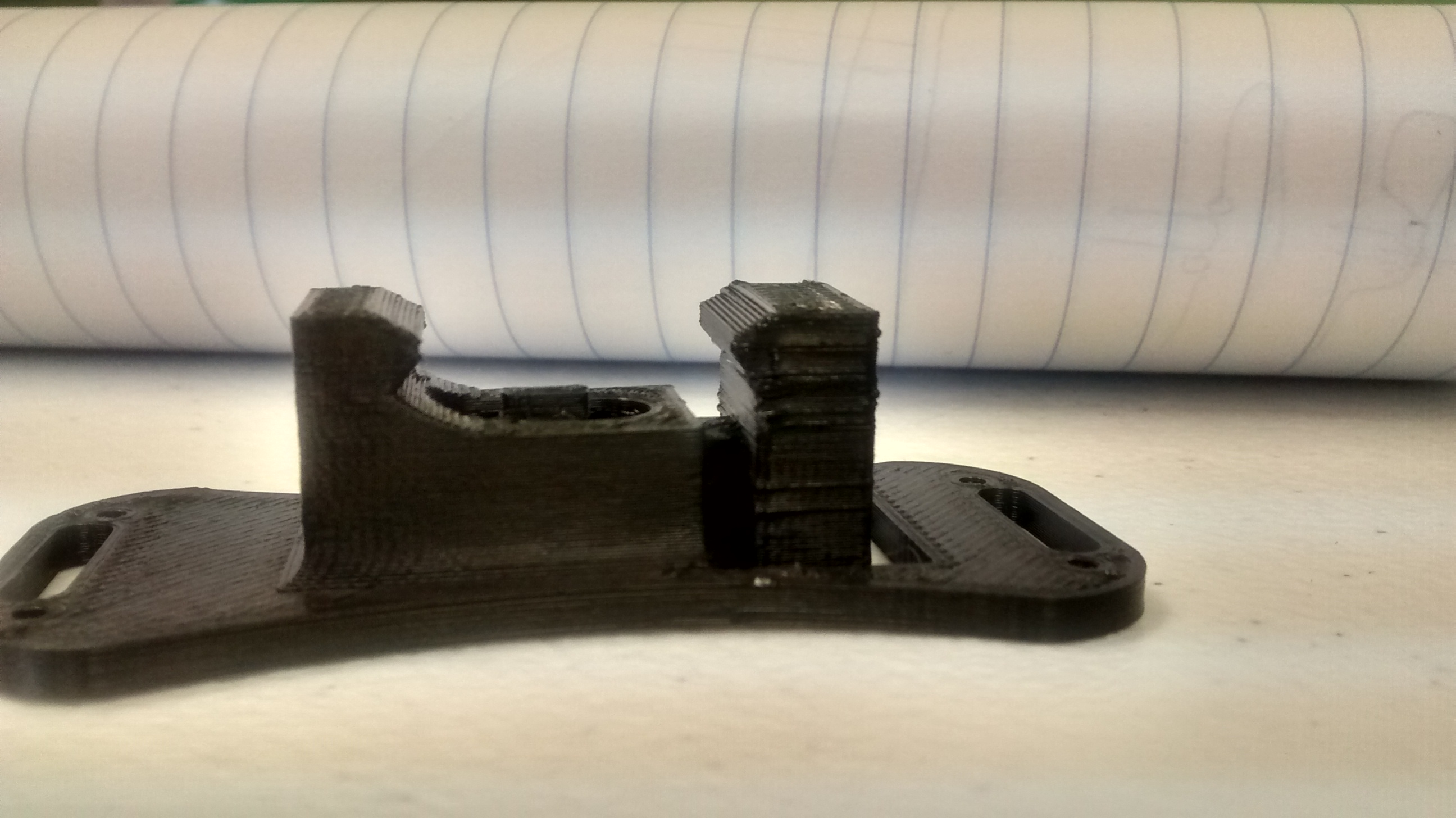

Hello all,
I have been printing a few parts for a project of mine, but it seems that M2 has trouble making a good finish on the part (see attached pictures - sorry for the photo quality). I have printed 5 similar parts, and each of them had bad finish in the same exact places. There are so many little protrusions on the right side that I have to shave them off for the part to fit into the groove it designed to go into. Since the left and right side of the part is almost identical, I wonder why M2 messes up so much on the right side. Is it a Slic3r issue? Is it temperature issue? Any other issue?
I can live with some small imperfections in finish, but I would like my parts to be as smooth as possible. Can someone help me figure this out?
Thanks!

its all in your settings really. its hard to tell but it does look like your over-extruding just a little bit. im not familiar with slic3r and its settings but you need a little more ooze control and possibly more time to cool the layer. the ooze usually happens at the start of each line. wish i could help more but but unfortunately i use s3d as well as many other here so i dont even know what kind of ooze control settings are in slic3r.

Pavel wrote:why M2 messes up so much on the right side
It looks like the object has a bit too much plastic, which suggests that the filament diameter & extrusion multiplier aren't set quite right. In particular, the top fill looks slightly overstuffed.
The default value for Infill -> Solid Infill Threshold Area is, IMO, way too high and has probably turned that small column completely solid. I run with 5 mm^2 and that seems to work for the stuff I build; if you do lots of tiny spires, it's probably still too high.
Set Infill -> Solid Infill Every x Layers to zero, which will prevent Slic3r from generating horizontal bulkheads inside the object. Sometimes you want that, most of the time you don't, because it produces effects that can be seen from the outside.
If you aren't already using http://gcode.ws/ to preview the G-Code before printing, now's the time to start: you can examine exactly how the printer produces that column, tweak Slic3r settings, adjust the model, and iterate until the right answer pops out.
Other than that, though, it looks pretty good.

ednisley wrote: It looks like the object has a bit too much plastic, which suggests that the filament diameter & extrusion multiplier aren't set quite right. In particular, the top fill looks slightly overstuffed.
Thanks ednisley for the help. I did have a very high Solid Infill Threshold Area (70), so I changed that. I also made sure that the outside perimeters are printed last. What is the extrusion multiplier?
