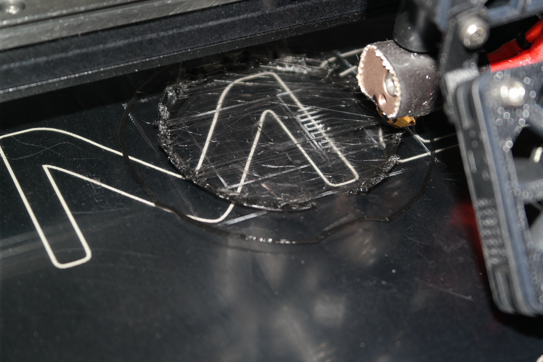

Re: How to control ozzing and stringing
This is the problem im getting
- (969.69 KiB) Downloaded 820 times
strings like that are controlled by the retraction setting. as jin said 1 - 1.5mm usually is enough.
