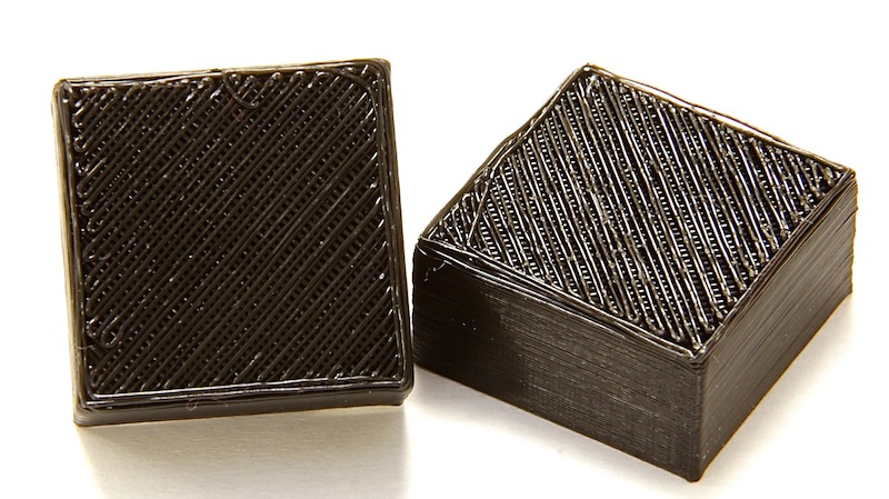

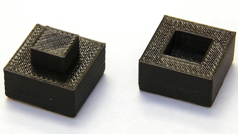

Hello all,
I'm having trouble getting the 3d printer going at our school. We have an M2 with the V3B Extruder running on a Macbook OSX.
currently using printrun (mar2014) and Slic3r 1.7.0
Our models are comming out very stringy and not well formed and sloppy. Is this a z Height problem? I'm technically inclined, but i've never dealt with the business end of a 3d printer so keep it simple please.

I have tried out ketil's to start with actually, and it produced some pretty bad results for me. first thing i noticed was the temps were really low (175), so i raised the extruder tip temp to 215, and for printing a whistle (on tinkercad) i had the bed start at 65 and lower to 55 after the first layer because the ball for the whistle would get loose and move around.
that's about as far as I got. the top layer stopped short on the whistle only forming one weak layer on top. I'm not sure what went wrong, if the machine stopped short or if the Gcode was bad. I may put in for the school to get s3d since we would just need one license, not a classroom set.

Ketil's settings may be for an earlier extruder which used lower indicated temperatures. I habitually print PLA at 225 with a v3b, although you will see a wide range of usable temperatures.
There are a large number of settings available in every slicer, and at some point it will behoove you to read through every one and understand what it controls. They are for the most part similar across slicers, though. You may need to change the number of top solid layers, for example.
Check out that M2 tips thread I linked for some general getting started tips.
If you can post your profiles/pictures, we can provide more targeted suggestions. You may need to zip files up to attach them.

Matt, Simplify 3D software is a super ez way to go. Not sure if S3D works on a Mac.
S3D has basic machine settings for the M2 with the v3b extruder.
Stock settings for PLA and ABS in S3D are OK without too much fiddling around.
Head space to table is critical, I use .005 to .006, higher, or more clearance than that, strings from
the filament cooling too fast to melt into layers, had this happen top me.

Both Ketil and I posted settings that were for the older M2 with the original V3 extruder and the dual 12V/18V setup. When I was using slic3r, I would usually set my temperature manually from pronterface, but if there are any temperature setpoints in the files we posted, they are guaranteed to be 20 degrees too low for the V3B.
Post a picture, if you like. After enough prints, you start to get an intuitive feel for what kind of problems correspond to a particular type of "sloppy" or "malformed". Sometimes, anyway.

Okay so heres the roundup of my settings and what not.
EDIT: The print did have a brim on the bottom of the object that was pealed off.
