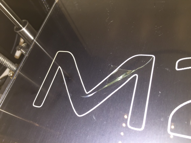

So I noticed some of my larger prints were lifting at the edges away from the borosilicate surface so I began printing with elmers glue stick which seemed to work great...until I cracked the glass trying to pry a 40mm calibration cube off with a putty knife.
Printing with makergear black pla. Bed: 60c, Extruder: 215c
So my question is:
Was I just too rough and not patient enough?
Or should I have done something else instead of the elmers glue? I would really like to avoid using tape if possible. Should I be adjusting the bed temp after a certain amount of layers or ?
I'm guessing makergear direct is the best place to order new ones?
Newbie mistake I know.

Did you wait for it to cool down before prying?

I did. It was completely room temp. After trying to pry at it for a bit I ran the whole thing under water hoping the glue would wash away...which it did. But it still took considerable amount of force to pry it loose and that's when it cracked. A chip of glass actually remained stuck to the bottom of the print.

I have a pair of flush cutters that I "nip" at the corners of sharp parts with. It gets under them and they pop right off.
You might have to soak the parts overnight in water.

I recently noticed that the corners of my plate looked a bit chipped, in the way that brittle glass for lenses can chip away at the edges. Haven't had any issues as major as that though :/
As far as stickiness goes, I put the first layer down at 65C and then let it cool to 60 for the rest of the print using bare glass. any questionable prints get a 2mm brim and they hold tight. no issues with adhesion so far.
Before every print I "shave" the bed with this http://www.thingiverse.com/thing:301592 and then wipe it with a microfiber cloth.

I use a cricut spatula (small arts and crafts thing) to get corners and edges started. I've been using hairspray on glass lately and it seems to works fine with a nice shiny bottom (PLA). For kids' demos I'll continue with the blue tape wiped down with rubbing ETOH (2X). I prefer the simplicity (no heated bed needed, no spraying). The nice smell is also a hit with kids.
