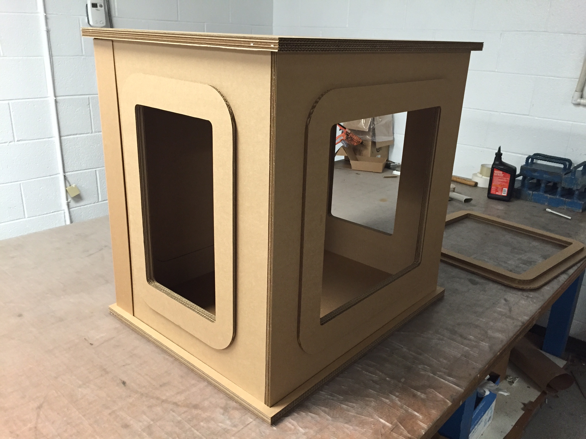

Here is an image of the enclosure I made. I am an Industrial Designer by trade working in the packaging industry, so I have an unlimited supply of almost every grade of corrugated paper, solid fiber and folding carton materials...which created this:
The front window 'pops' out to allow the changing of filaments. I have a V4 dual upgrade kit coming, so I made it wide enough for another spool on the opposite side if the original spool holder.
