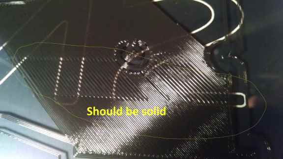

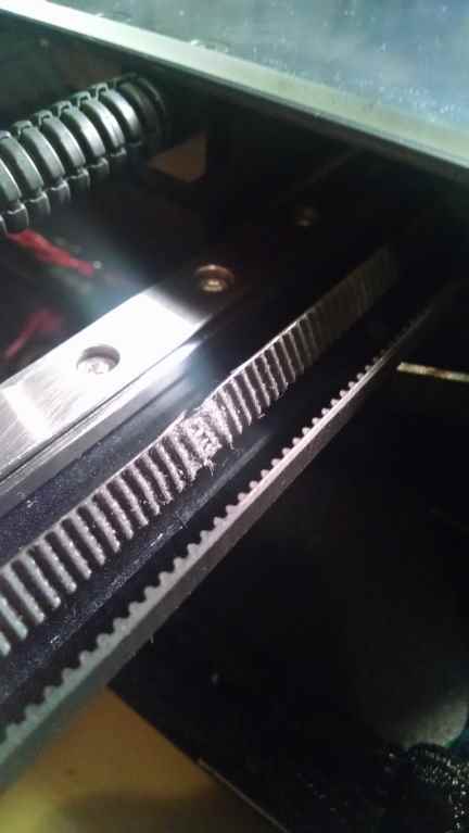

I was having odd problems with "see through" sections and other strange issues like layer shifts and blobs. At first I thought it was a "dial it in" problem, then a slicer problem, but narrowed it down to a bad spot in Y the belt at the mid point. A new one is on the way, but I thought others should be aware to check the belts. I have uploaded a picture of the odd pattern and the belt.
No idea what would have caused this, perhaps just a one-off problem.
Odd pattern
Bad belt

Re: M2 new user experience
Post by Jules » Wed Jul 29, 2015 7:35 pm
Yup. Bad belt. :shock:
(Don't ever remember seeing it mentioned anywhere else though, so it's definitely not a common thing. Bummer! :cry: )
