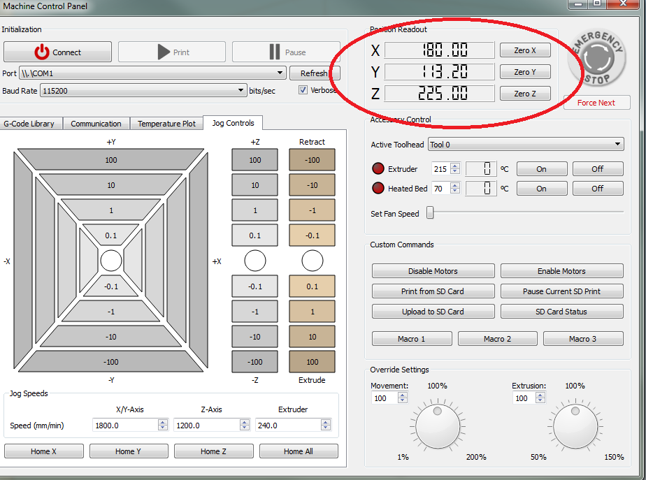

Re: Initial Problems
Sorry...by the "tool change values" you mean these, right? You're saying that zeroing these seems to fix any issues you are having?PcS wrote:I have noticed if the tool change values are populated in s3d ...which for some reason it has happened twice it has given me ridiculous retract on the extruder. And once it did something similar to what you describe. I just zero them out .
