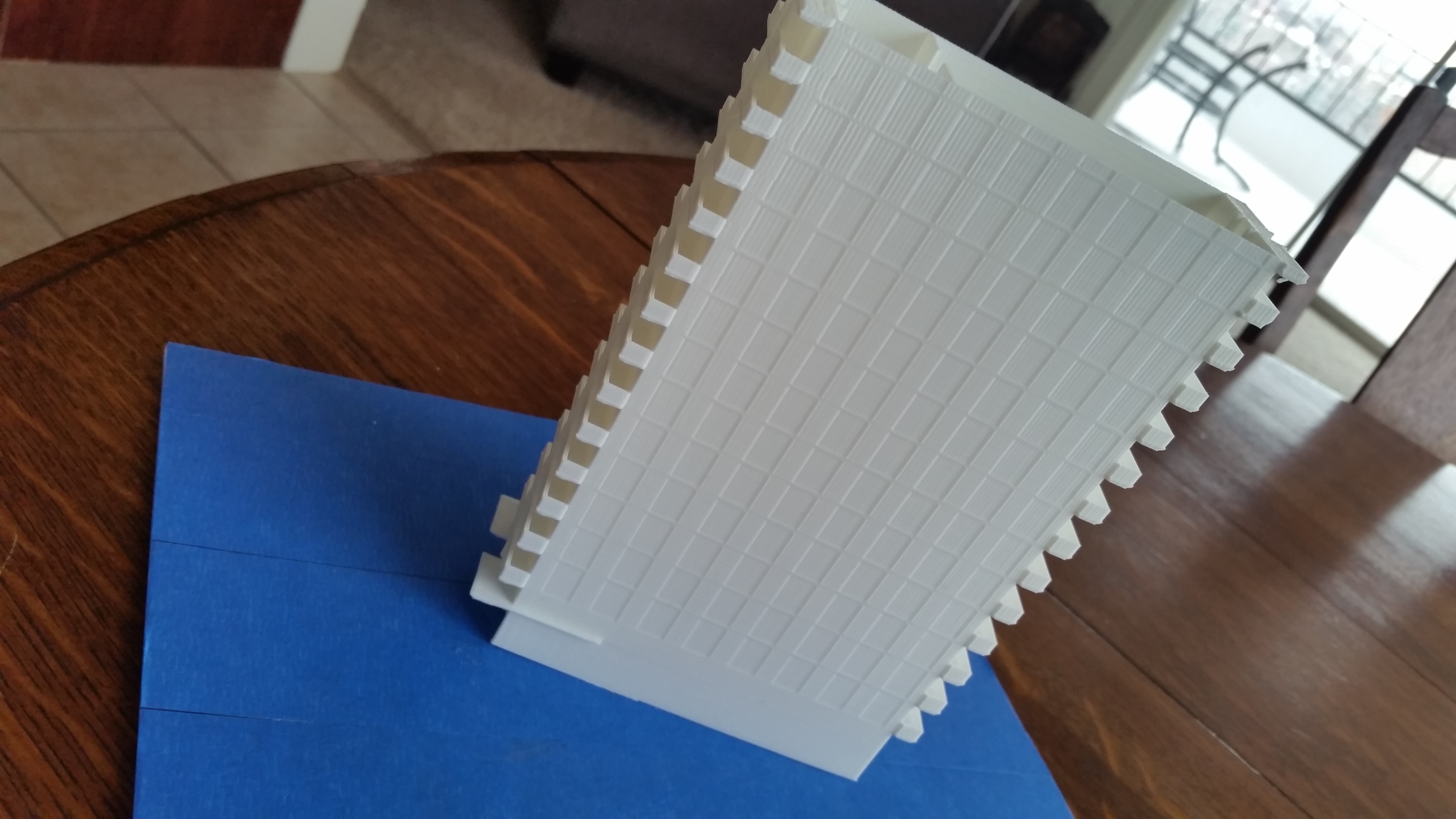

Prints pulling up at corners

Yes plate is clamped. I've been trying to print this building for three weeks now. Been asking questions on here for two weeks. Read as much as I could. But so far, these are the best results I've seen. My boss is less than forgiving, and we had a last minute meeting come up with the money man.

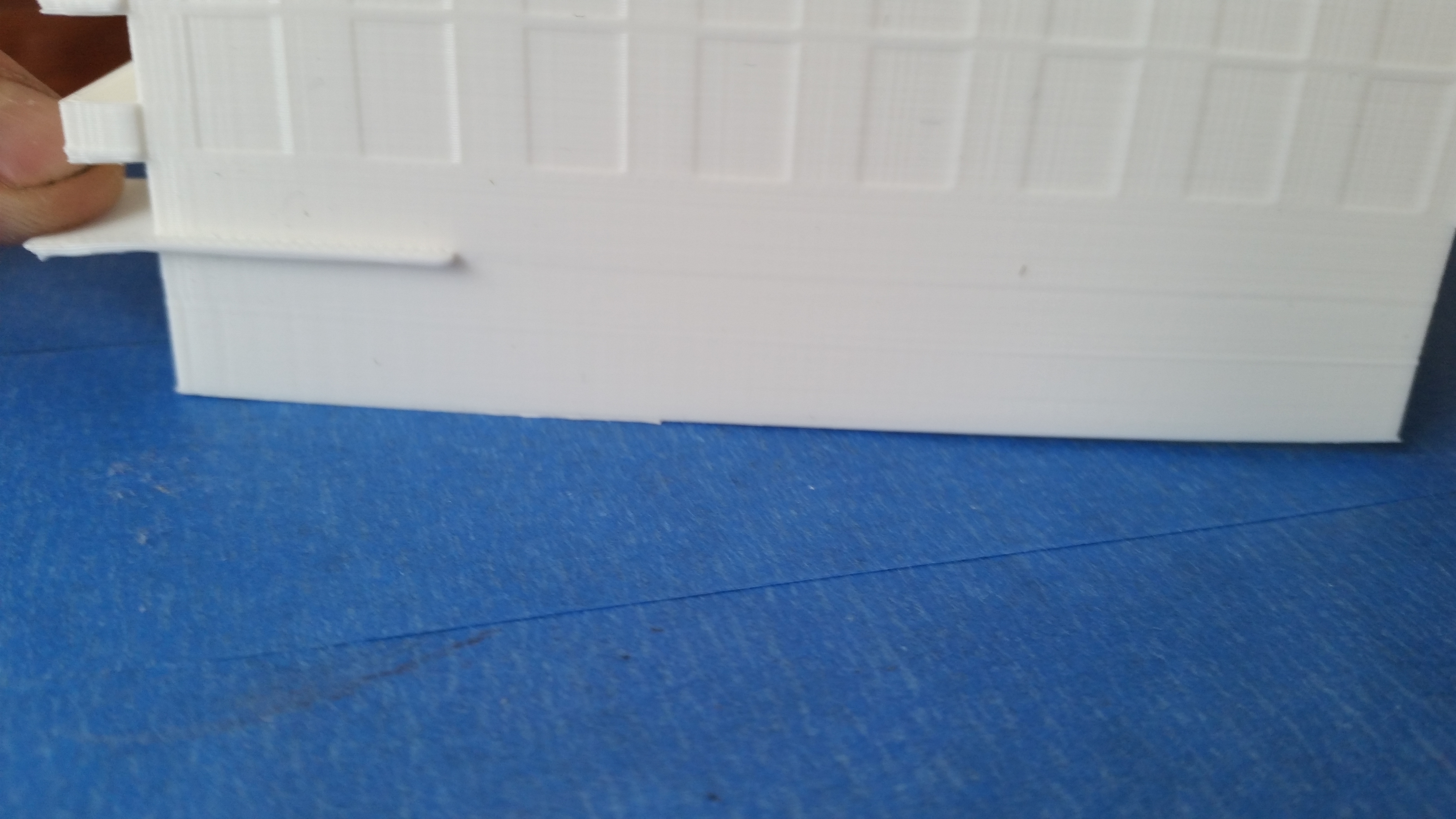

Woke up and print looks ok, No major warping at least. Before I took it off zebra plate it looks completely flush with plate The brim doesn't appear to have warped at all. No gaps.
But then I carefully take it off, peel and cut away brim. And set the model on the table and it rocks. It is not perfectly square. WTF? What the f*ck is going on? is it not possible to print something that is square. So now my second piece will not align properly.
Re: Prints pulling up at corners
Yes the part adhered to the olate and it just warped the plate which is why inpersonally quit using thise type of flexible plates. I know jules and many people like yhem. To each their own and if it huves them good results then thats great but not me. I need something rick solid and flat. You have to realize that your fighting mother nature here. Every layer is put down hot then as it cools ut shrink a little. It might ni be alot of stress but do that for as many layers are in your model and you end up with a ton of force curling your print. It like having to small boards with 1000 rubber bands stretched between. The larger and more square your print the worse it is. Your better iff printing things in small parts and assembling like a model. Your printing pla too which is considered very low warp. Abs is 2-3 times as bad lol.

Well, I guess I haven't tried this new brim technique with glue and hairspray. Maybe that will work.
I'm flipping the second model piece upside down and redoing supports so the top will be the bottom and be more square.
You can take a rectangular bar of cold-rolled steel, machine off the top surface, release the clamps, and watch it curl up. The rolling operation introduces stresses into the bar that are perfectly balanced until one side goes away, at which point steel can't withstand the stress.naturalstate720 wrote:is it not possible to print something that is square
You can cast the concrete floor of an aircraft hanger in one piece, but then you'll watch it crack as the concrete shrinks while curing.
Your model is asking too much of the 3D printing process: it's a large flat plate with ribs & other features on the top surface. The plastic shrinks as it cools, by perhaps 0.5% (depending on the material), so each raised feature "wants" to be smaller than when it was printed. As long as the plate stays stuck to the platform, those forces are balanced and all is well, but when you remove it, the unbalanced stresses will deform the plastic.
If that wall (it looks like a wall) is about as long as the platform, its length wants to shrink by 0.005 x 250 mm = 1.25 mm. It won't be quite that bad, because the plate adhered to the platform holds the upper features in place and they stretch as they cool, but it gives you an idea of how much distortion you're up against.
Just as the machinist would use hot-rolled steel and the contractor will put joints into the concrete floor, you must adapt your models to the "construction" technique you're using. Cut it up along whatever natural lines you have, add registration pin holes to the edges, print those smaller sections, and glue them together. They'll fit just fine and you won't have to worry about what happens to a lengthy print in the dark of the night...
