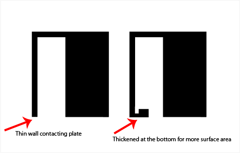

Is that part of the building hollow at the base?
How thick are the walls at the base where it contacts the bed? Are they really thin? (Just a few widths thick? Same thickness as at the top and your window wells?)
If so, it's no wonder that keeps warping, and i'm amazed that you've gotten prints as good as those are. (That last one looks pretty good, all things considered.)
If those are thin walls at the base, thicken them by at least 10 mm. Even better would be to make them solid. Just at the base, and you can put the thick part inside, so it's not visible. Make them about 4 mm tall for good stability.
If those are as thin as they look, there is literally nothing holding that down to the plate except the brim, and that's not enough to hold down a structure that high against the "forces of warp" that ed and jim mentioned. You need enough solid surface contacting the plate to keep things stable. I thought the base of that was solid, like the bottom part of the building, but that picture makes it look like it's hollow.

Most of the building is completely hollow. Half of the bottom is a partially solid rectangular box with heavy infill. The other half is a complete car entry and exit for robotic underground parking garage. It's a void space that spans the length of building. Boss really wanted to show it like that, so there is only a thin wall on one side.

So you have a garage underneath it that runs the length of the building, and you basically have one or two thin walls that go down to actually contact the plate on the outside? (Am i reading that correctly?)
And those thin walls are where the warping is occurring? (Sometimes?)
The support is going to help everything above it, it's not going to do a thing for something that is just effectively standing next to it, unless you actually attach the support to the walls. Then it might help to hold it down. Or it might not, support tends to be thin by nature in order to allow it to be removed.
I'm sorry, because if i had seen what you were trying to do sooner, I might have had some ideas that might have saved you a couple of weeks of lost work. But none of the photos up till now showed that hollow spot.
I don't know of any quick guides that would tell you how to design for 3D printing - the one thing that's helpful to remember is that the more surface area that you have contacting the plate, the less trouble you are going to have with prints pulling up when they warp.

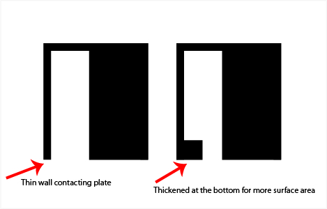

Couple of things that might work:
1. Put a bottom on the garage. Have a solid surface that goes all the way under the building. And it needs to be merged with the design, attaching to both the outside walls and anything in the interior. Make it about 2 or 3 mm thick, and use about 4 or 5 bottom solid layers.
2. Thicken that outside bottom wall so that more surface area attaches to the plate. And by thicken it, I mean it needs to be about 10 mm wide to give enough surface area to hold it down. It's so thin, compared to the solid area, that that is where the warp is going to happen.
3. Cut the design up into several pieces so that they are not so tall, then glue them together like the guys suggested. You will still want to put a lip or something on the inside of the parts so that the thin walls are securely anchored, and so you will have something to glue together.
This was not something you would have known to design for, or to ask about. In the future, you'll know to incorporate it into your designs. But it is something that people who create files for 3D printing work into their designs.
Update: That first diagram was rather lousy - i'd actually design something that looked more like this, so you could cut it off more easily after the print.
