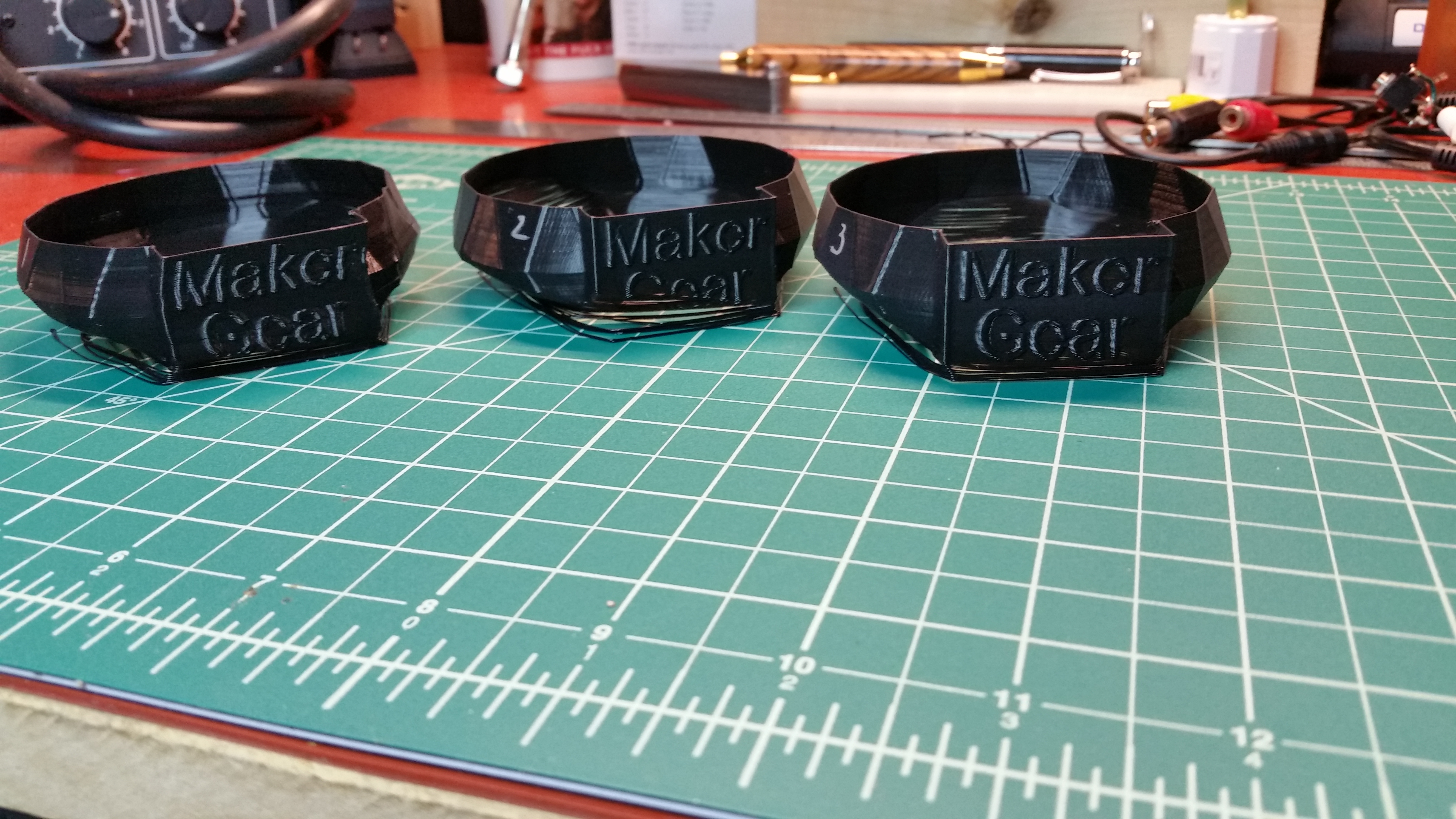

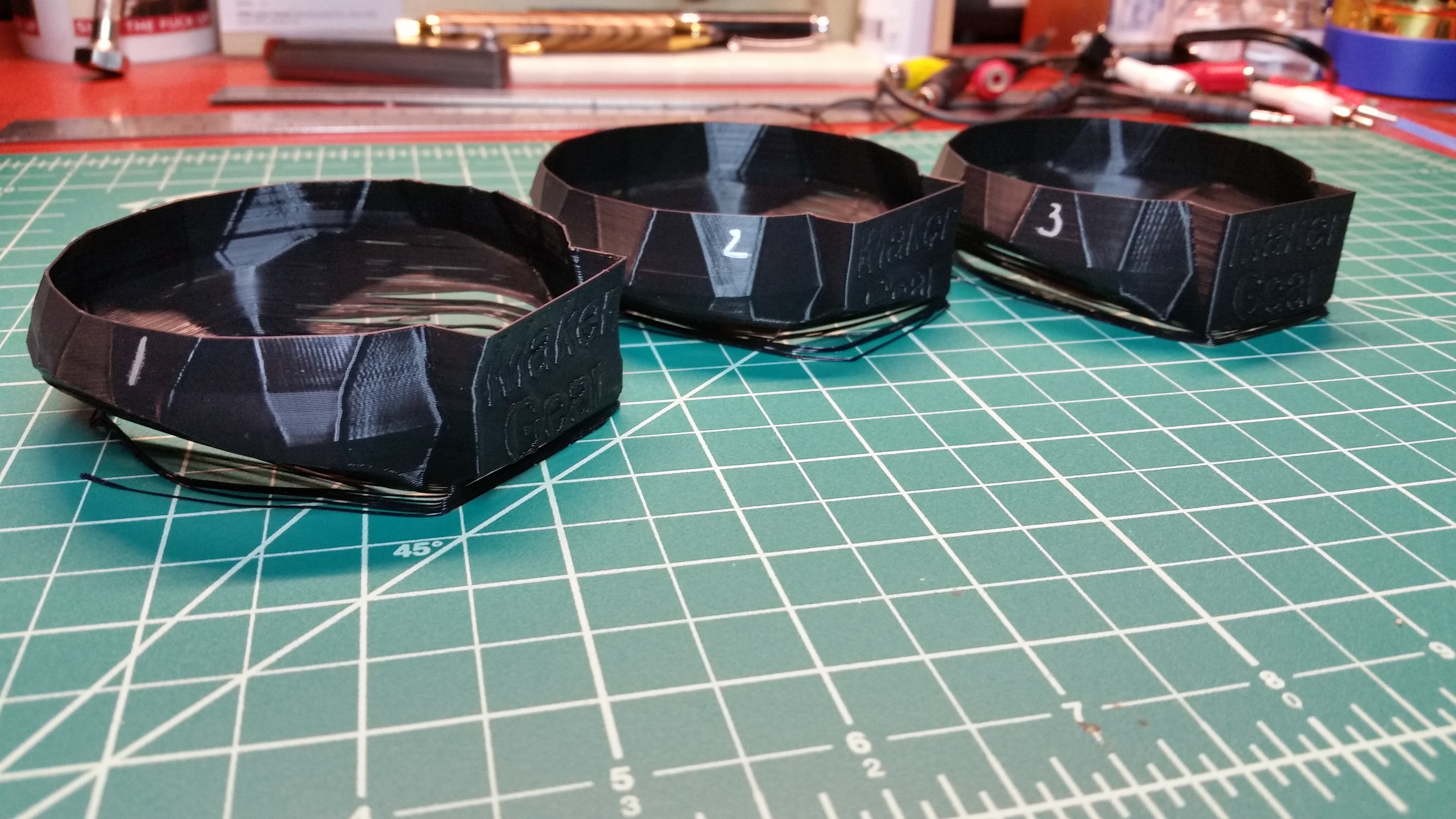

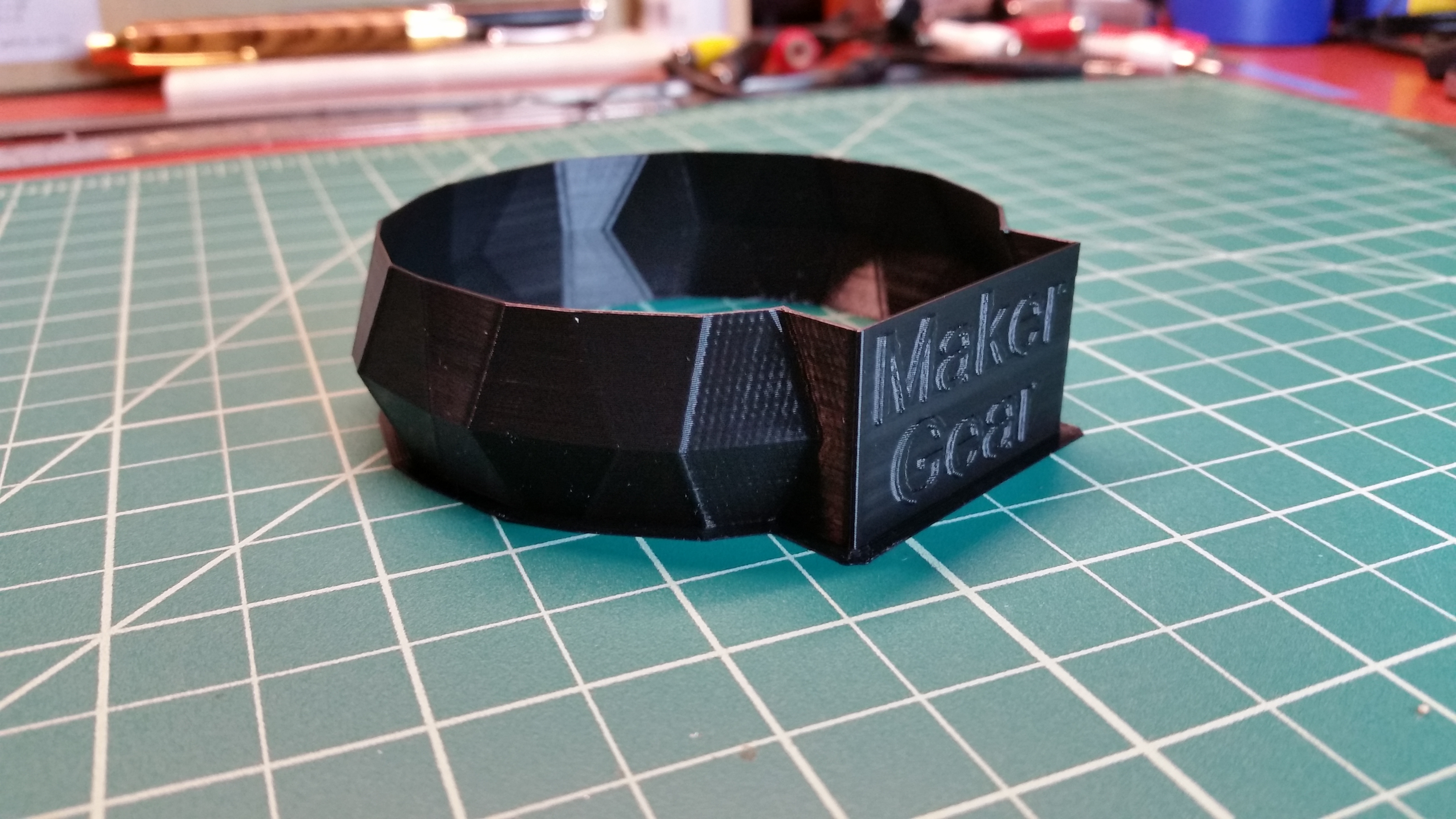

Hi All,
My M2 Rev. E just arrived today and I've been working with the new "Quick Start" app. I've run through about 4-5 iterations and everything seems to be bang-on using a 0.15mm feeler gauge in lieu of the included blue strip.
However, when I print the bracelet.g file on the SD card as instructed by the app, the first few layers are always way above the bed.
Is the setting not getting saved and used?
FWIW, I also purchased and am using the LCD interface from MakerGear.
Pics of the first three attempts attached:

It's fine now...I had to run through a few more calibration cycles (6 total) and eventually the first layer was right on.
