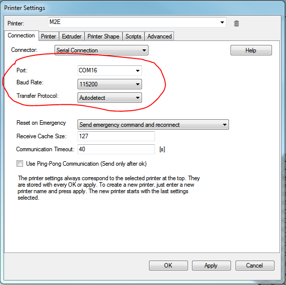

After installing reptier-host (don't worry about repetier-server), first set up your basic settings in Config->Printer Settings (important stuff circled in red):

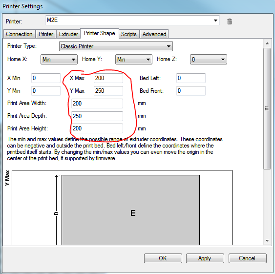

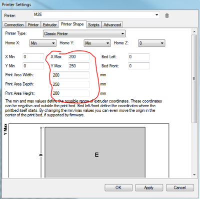

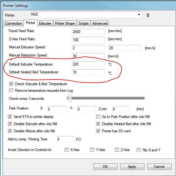

Communication settings: Default temps for PLA (assuming you're using the spool of PLA included with your printer): Print area dimensions: Copy the config.ini from the SD card to your computer Then import your slic3r settings (this is where the tweaking magic happens):

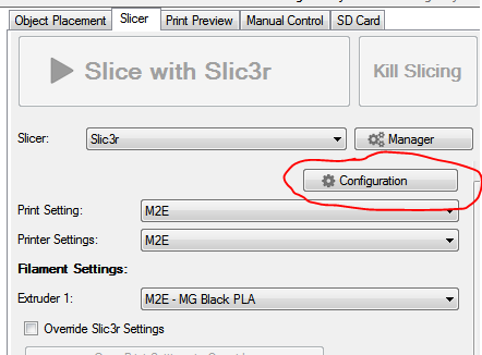

Make sure slic3r is selected in the drop-down box, then click the "configuration" button. When the slic3r window appears, select File->Load Configuration Bundle. From there, choose the config.ini you copied from your SD card

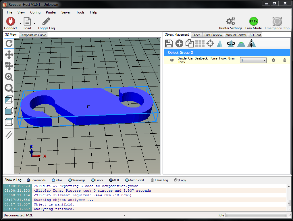

Place an object on the bed:
Object Placement tab
Click the plus icon to add a model to the bed
Position it (right-click and drag to move)
Rotate, scale if needed.

Slicer tab
If you imported your settings correctly, you should see 3 drop-down boxes (Print Settings, Printer Settings, Extruder 1) all with "M2E" selected
Click "Slice with Slic3r"
