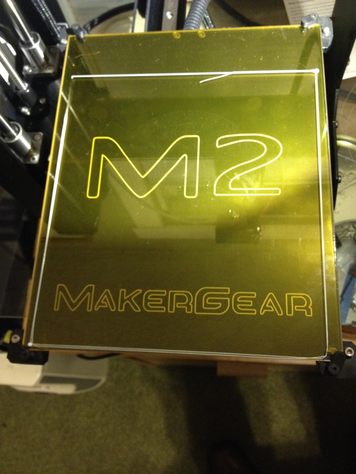

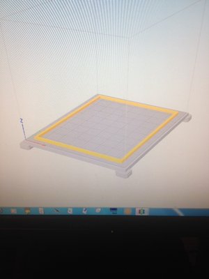

So I created a rectangular model that just about fills up the virtual machine bed in S3D. But when I try to print it the top edge of my M2 printer bed does not travel all the way to the nozzle in the Y-axis. You can see that the top horizontal line of plastic is extruded about 3 inches short of the top edge of the glass. That's as far down as the bed will travel.
I can move the bed down with the S3D jog controls until the nozzle is slightly beyond the top edge of the glass on the M2, but when I run the print of the model, the M2 bed just won't move down far enough.
Shouldn't the bed travel further down so the nozzle can print to the top edge of the glass?

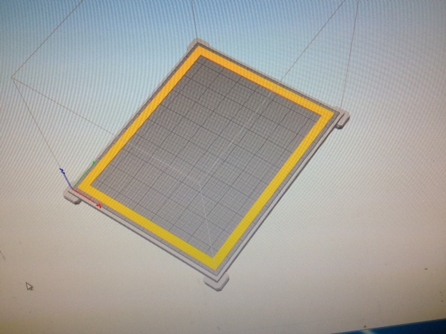

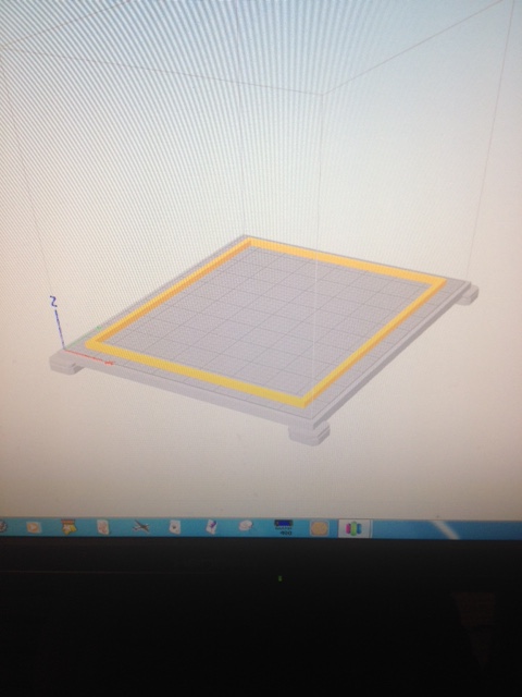

So I just tried a 7" (177.8mm) x 9" (228.6mm) model in S3D. (picture below) If S3D were to center this print on the M2 bed as it should this size gives plenty of room for the clips.

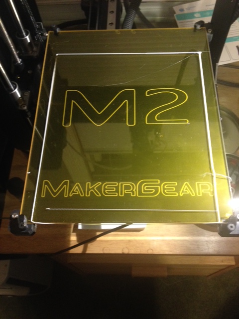

The M2 bed pic shows that the first bottom horizontal line starts off at about the correct place but as the bed moves down it still stops about 1.5" from the top.
(In my previous post I said that is was about 3 inches but that was an incorrect guess on my part. I never really measured it the first time.)
The M2 vibrates badly for a second before making the change in direction when it hits its limit.
On the second pass when the bed moves up it causes the nozzle to hit the clip at the bottom left corner and runs the bottom horizontal extrusion out beyond the glass. That can just be seen in the photo of the M2 bed.

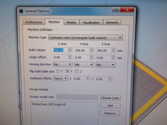

I even tried changing the offset in the option / machine tab in S3d. No change. For some reason S3D is not in sync with the Y-dimension of the M2 build platform.
So is this a software or a hardware glitch? Or do I have something set incorrectly. Being a newbie at this I have no clue why the Y-axis is so out of whack with S3D.

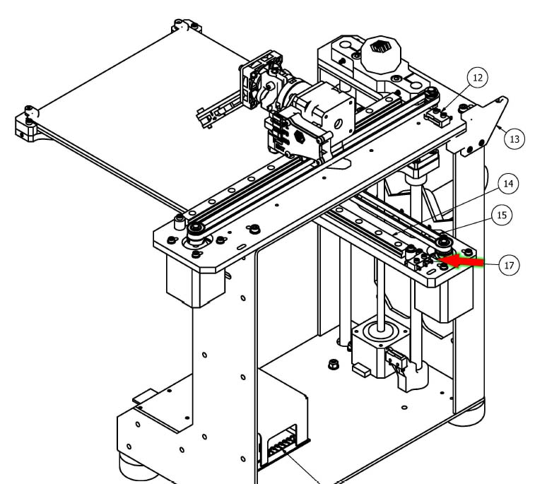

This is your limit switch. (Back of press shown by the Red Arrow)
Pull the bed forward.
