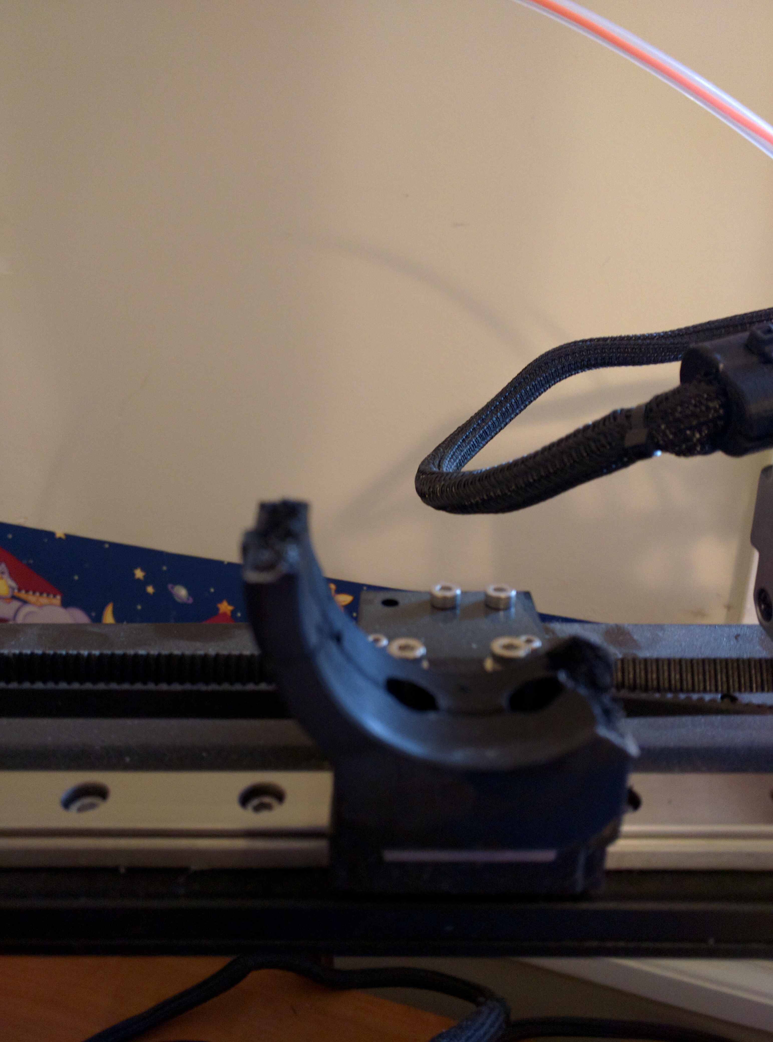

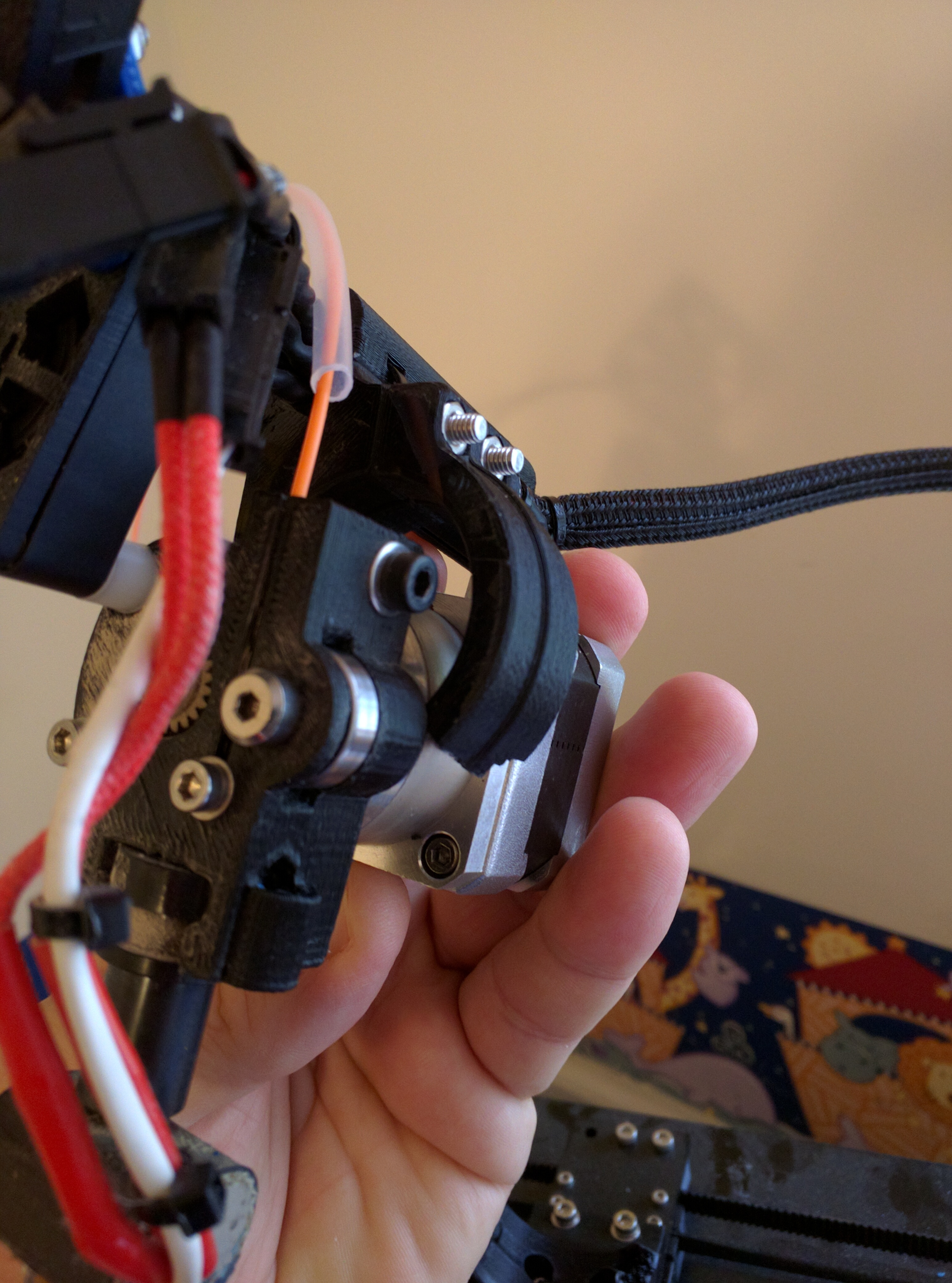

Yup, you were totally right, it is now not only cracked but totally broken. Not sure what to do,If your extruder is pivoting, that is a bad sign. Make sure it isn't cracked, and it is seated properly and all the screws are secure.
Re: first layer temperature
Post a photo of the cracked part, you might need to replace it.

Jules, it's more than cracked, while checking it out, it totally broke.

here are those pics. I will try to send an email to makergear & see if I can get a replacement... Thanks guys..

Yes, that's your motor mount....they do sometimes crack. (Haven't seen one crack quite that thoroughly though. ) They can replace that.
(A lot of us print our own replacement mounts out of PETG or PC once we get a little proficient with the machines - at higher infill, they're just about indestructible. Or MakerGear now offers a thinner metal mount guaranteed not to break. (Last month or so.)
Bad luck, but totally fixable!
